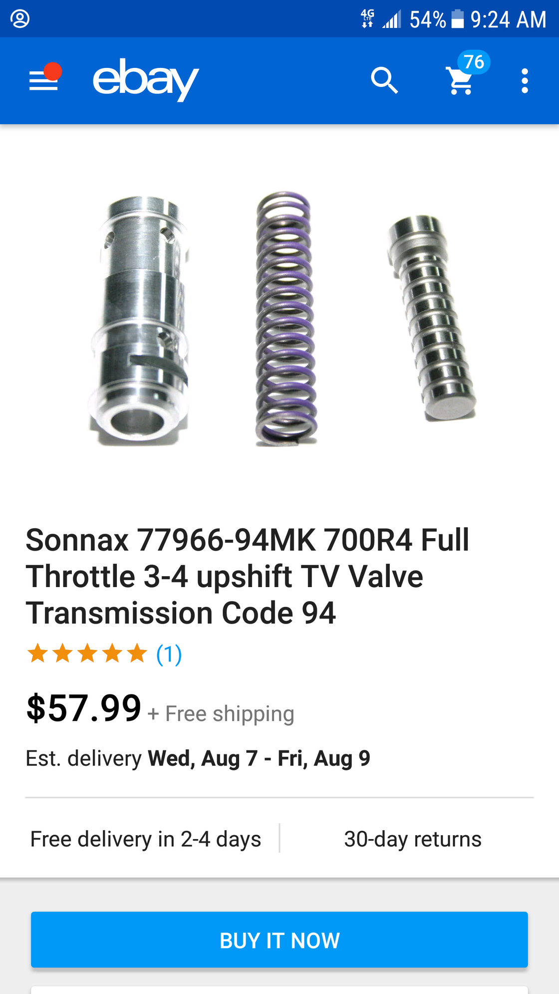

Sonnax makes a valve for the 700R4 that allows WOT 3-4 shifts. Its about $60, i would buy that over attempting to make my own 3-4 valve

Damn and blast! I was hoping for a response from Pro Built Automatics but that is not what I want to hear.... Also I did try that Sonnax valve first and that didn't work either, but that valve is different than the modded stock one, that's why I then tried the mod.
