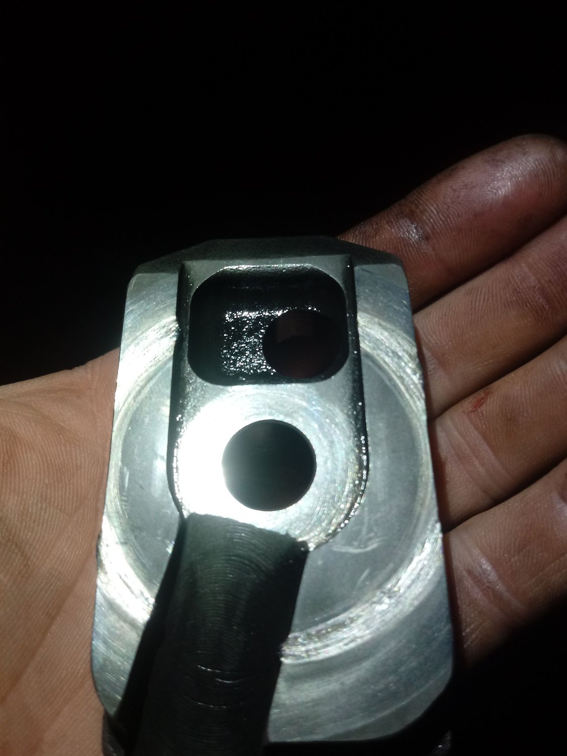

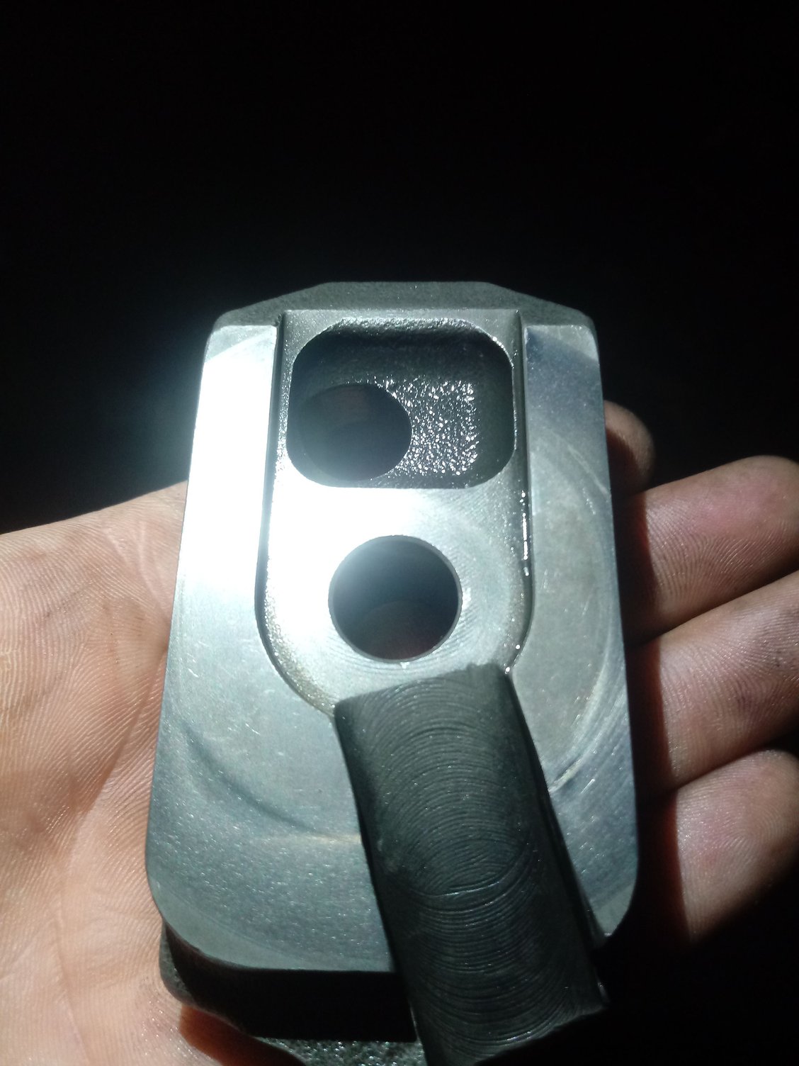

Picked up another rear end off an 02 SS with 3.23 gears. I' m no diff expert but the gears look ok . What really has me worried is the wear on one side of the paddle. There is some bad scoring. Not sure what it could be. Any torsen experts. ? No broken tooth.

Polish and run it. Lateral play from the axles is all you're dealing with.
Pull it at next fluid change-out for inspection.

Cool thanks bro. Noob question how do I polish it? fine grit sandpaper?

Depends how deep the scratches are. From the picture it looks like 120 grit would be needed to start.
Might have been run low on oil or the oil got cooked,
