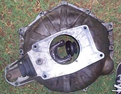

Does the t5 sit at in angle i was looking at a bell housing that is suppose to be off of a 89 iroc-z and the bolt pattern was angled. Will this fit my 85 rs that im converting to a 350?

It looks like the do on my friends cars.

Yes, they do. I'm not sure of how much, but it definitely is turned toward the driver.

WOW. I know the T5 in my brothers Mustang is angled, but not nearly as much as one in the picture.

yea i just got some info its angle 18 degrees
