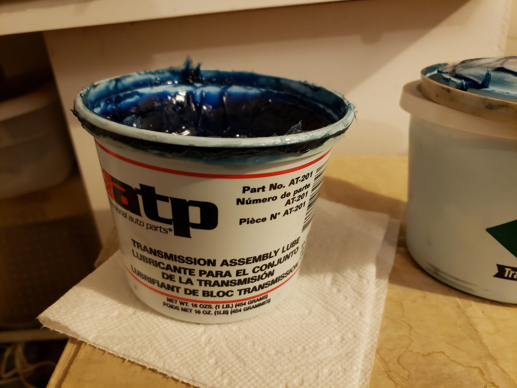

All I can tell you then is to lube the seals and the case - liberally with something similar:
There's different brands like Assemblee Goo, TransGel and come in different consistencies. I prefer the blue stuff over the green (in the container on the right), it's a bit more soft and tacky than the green stuff. Some people say Vaseline is OK.
