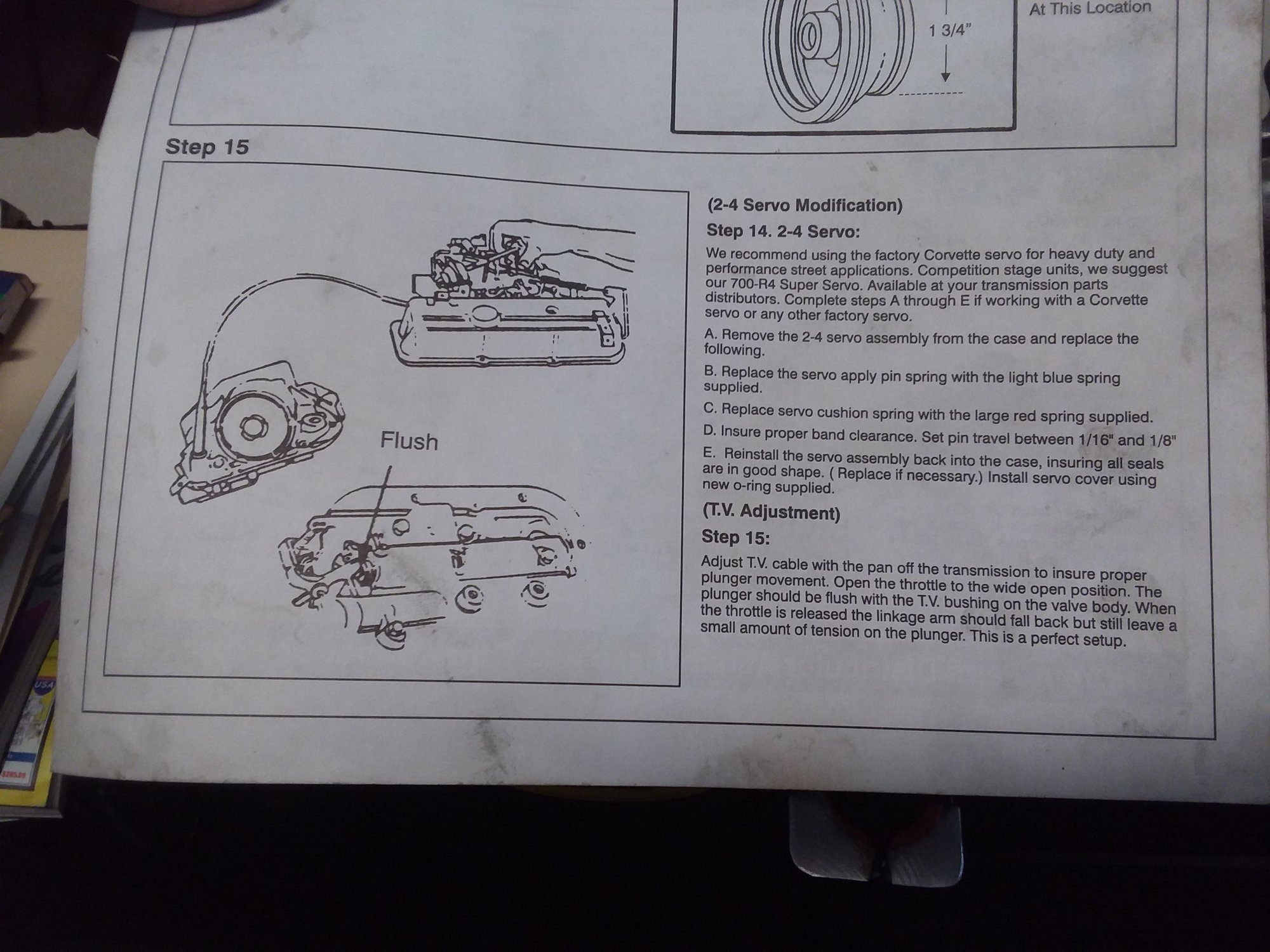

Got this from my tran guy. There are other ways but unless you have xray vision, you need to see where the plunger is. It also will confirm if your geometry is correct based on how far the plunger moves.
i have to remove the pan? I thought there was something I could adjust externally for tension. This will be a lot more work than I thought. The trans doesn’t always shift down like it should, and tries to pull 3rd at low speeds
