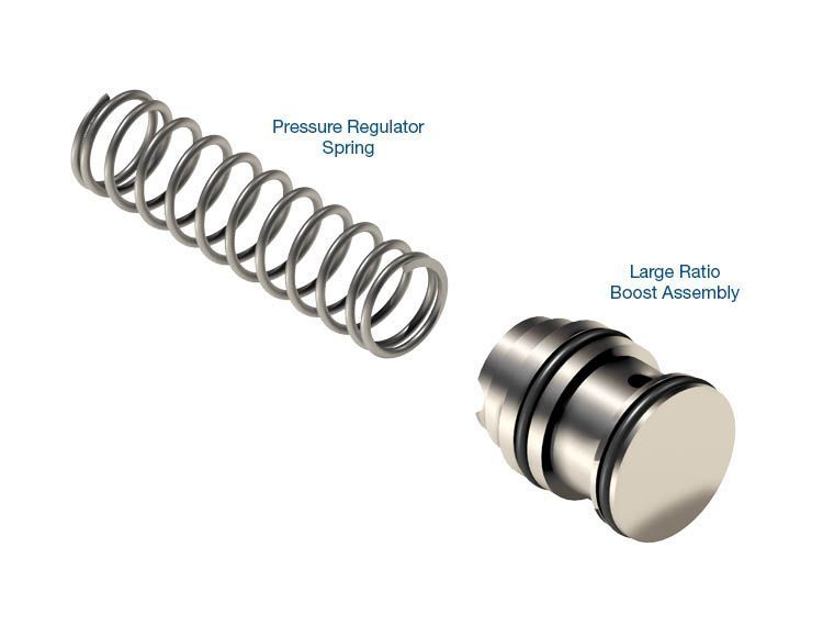

Here is a picture of the valve. I don’t know if it is .500 in measurement. Where would I measure to find the value of .500 inches. I guess the o rings help prevent leaks as well as they have a low reverse version also with o rings

The factory version is ..422". The intermediate is .472" and the largest is .500". The O.D. of the internal piston is what's measured.
IIRC, some are available with O-rings.
I've used all three and prefer the .500" version. Here's a link to the Sonnax catalogue page.
https://www.sonnax.com/parts/2491-tv-boost-valve-kit
