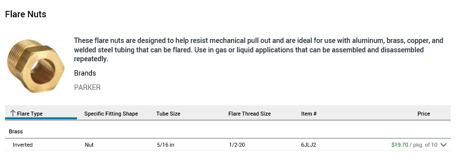

Any body know the Size and Thread Count on the Transmission solid tubing Fitting that Threads into lower part of Radiator?
Eyeballing it looks to be different than threads on Radiator.
1/2 x 20 sound about right?
Thanks
Mike

Tubing thread sizes - not machine screws/bolts.
But as it turns out, 1/2" - 20 is correct if the tubing is 5/16" OD.
Thank you for Verifying that information.
