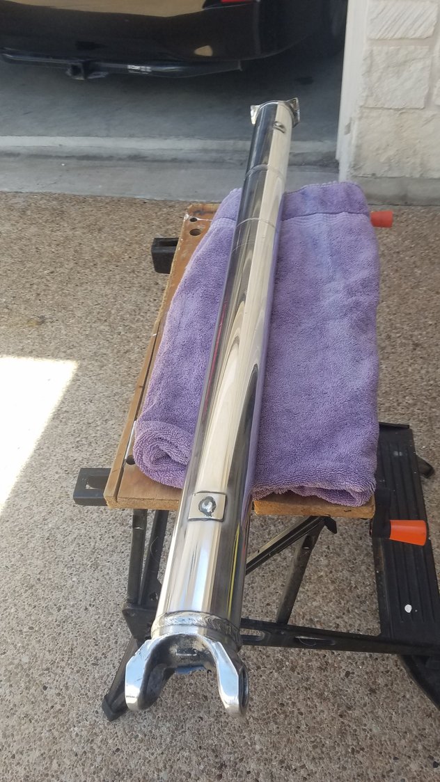

First thing I did was polish up the aluminum. Started with 150 grit, working up to 2000. Then polishing to a shine.
The polishing part was a lot of fun, something I enjoy doing. The driveshaft is nice because it starts with a good, smooth surface. Polishing up a TPI system or wheels takes a lot of work to remove casting marks (TPI) and machining marks (wheels). With the shaft, you could just get into the light sanding and working it into the polishing stage. I did a more in-depth write-up of the polishing process in another thread. HERE

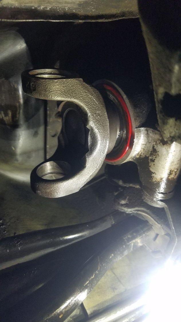

After getting the yoke into presentable condition, I wanted to test fit it onto the output shaft before going further. It wouldn't even get onto the shaft. I pulled it out and worked it over hard with a steel wire brush, sandpaper, anything I could think of. On second attempt, it would barely slide on, and that took lots of effort. I was getting ready to throw in the towel. Big thanks to a member here, jmd, for making the suggestion of naval jelly. I had a really old bottle on the shelf and got to work. First, I tried brushing it on and working it into the splines, letting it sit for 10 minutes, rinsing and repeating. That made a bit of an improvement, but not good enough to work.
Realizing that I could just pour the contents into the yoke and let the chemicals to their thing, I set the yoke upright in an old machinist vice.
Jaws on vice tightened only enough to keep the yoke from falling out. Two of these treatments did the trick!
I left the jelly sitting in the yoke until the bubbling action started to slow down. I bet it was 30 minutes or so the first time, then 1-2 hours the second. I kept removing jelly from the top as it reached the edge and was ready to spill over.
After rinsing, I ran a needle file down each spline to clean up the edges, and also lightly along the top of each spline.
SUCCESS!!

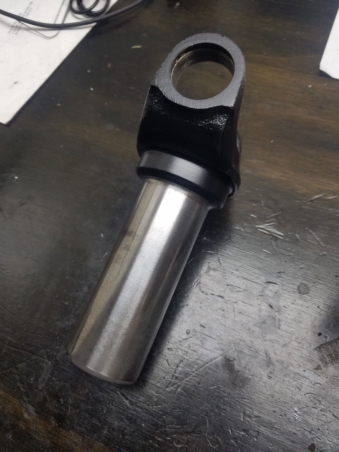

Now time to get it painted and keep future rust away. Wiped everything down with mineral spirits and added the car for flavor.
Finished and ready for U-Joints and installation.

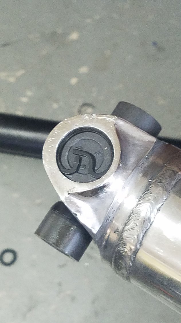

Also, something for people to be aware of when ordering U-Joints for aluminum driveshafts - they must be the coated version (the "C" suffix on the end of the pat number). Otherwise, the dissimilar metals between the aluminum driveshaft and the steel slip yoke and rear pinion flange will cause a chemical reaction and the U-Joint caps will essentially become fused to the steel housings. At least, that is my understanding.
Here is what the caps should - and should not - look like:
Moog 372C - I believe I was shipped a regular 372 part in a 372C box. Notice the shiny silver cap.
Moog 369C - Four nice, dark caps showing the coating. I swapped the two free caps in this picture with the two silver caps on the rear.
