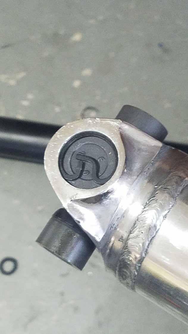

Related question: the u-joints that I ordered are both supposed to have the galvanized coating to prevent electrolysis reaction between the aluminum driveshaft and steel slip yoke and pinion flange. The front joint certainly shows the coating, but looking for opinions on the rear. Not the same, dark color.
Rear U-Joint. Moog 372C
Front U-Joint. Moog 369C

on the u-joints, I'm going to swap two of the coated caps on the front joint onto the rear. Put those two caps on the front where they mate with the yoke.
