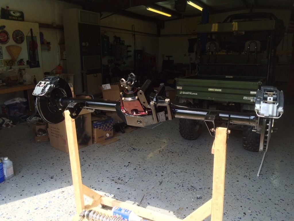

I have one (4th gen width) with a Spohn torque arm and it fits great.

Did your rear come with that TA mount?? That looks just like the one Moser uses on theirs. Mine had tabs on the top and bottom of the housing and a stupid bracket that bolted on.
