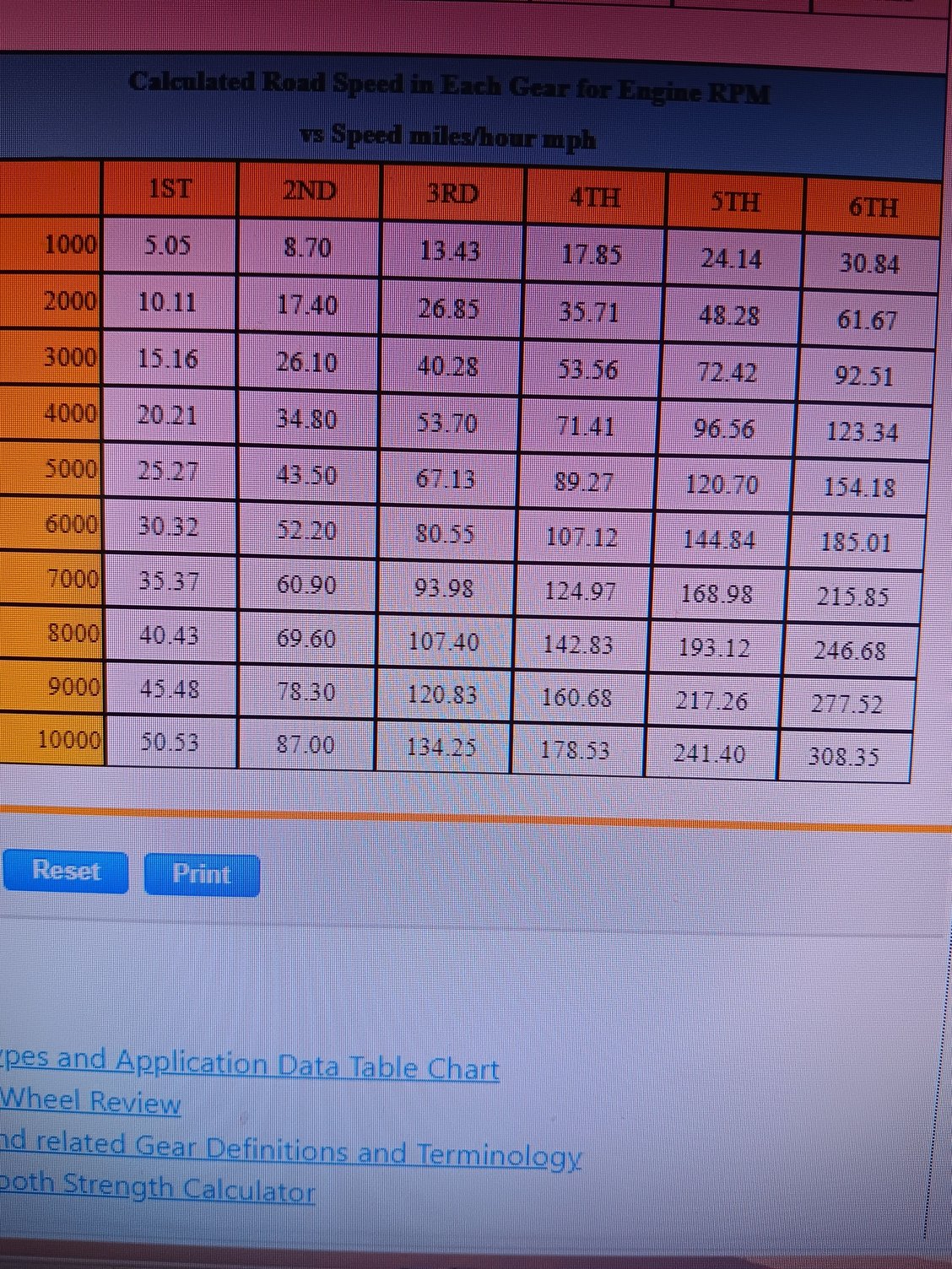

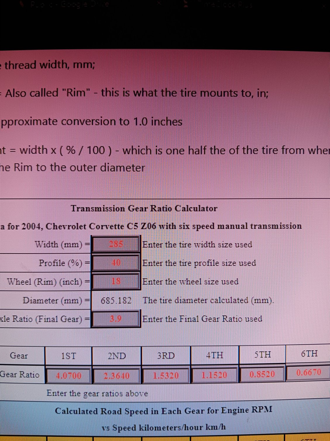

Re: 6l90 gear combo

You'll be going from a 3.06 first gear to 4.0x.
That's similar to going from 3.42 to 4.50 rear gear.
Definitely skip the change from 3.42 to 3.90.
The LS3 will pull 27" tire, 3.42, 0.67 sixth no problem.
Should be a very enjoyable upgrade build.
