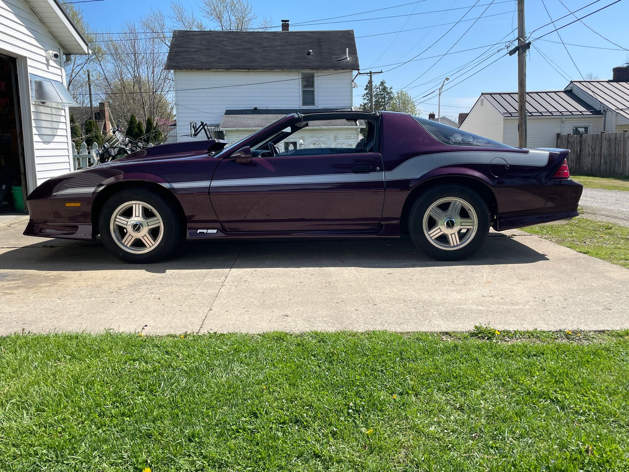

sweet thank you
I have the trans in and measured the drive shaft length which is 47ins from the tail shaft to the yoke
