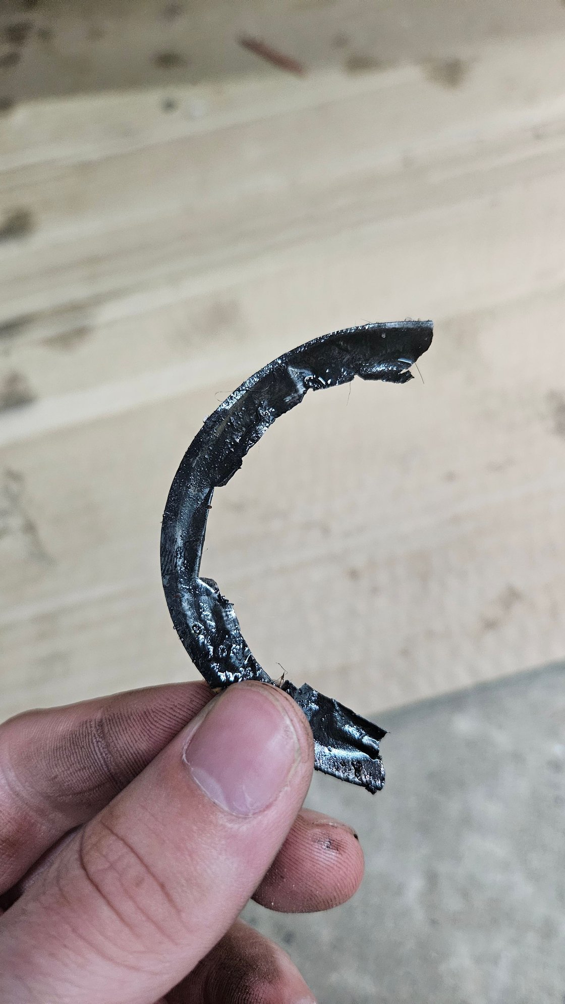

Jun 12, 2024 | 08:51 PM
Re: What rear axle gear ratio is best?
Upon further inspection, I realized I cannot count. It does have the 3.23 gear ratio (42:13), but it is a G80. I know because I can see the gov-lock parts. Maybe someone replaced just the carrier? When I took the cover off of the diff, there was a considerable amount of metal, and one piece is pretty significant. I will link a picture. I am debating if I should replace the whole carrier as well, or just replace all of the bearings, shims, and ring & pinion as mentioned before. I do not know anything about the history of what was done or for the whole vehicle for that matter.

Jun 13, 2024 | 12:45 PM
Incidentally that thing in your hand is probably the source of the backlash. Looks like one of the thin carrier shims out of a "gear install kit" (they come with 2 .100" shims for each side, then you stack up thin ones between those, to get the total thickness you need, which is usually anywhere from .230" to .260" or so). Looks like whoever put that rear together, didn't get the shims in there right, and that one got destroyed. It's not impossible that if you just got a set of carrier shims, and installed them properly, that alone might fix the noise. Problem then is, if they efffffed that up, who knows what else they knackered.

Jun 13, 2024 | 06:07 PM
Okay, thanks for the insight guys. I will just replace the ring and pinion along with all of the bearings and shims that come in the typical kit. The car is not worth pouring money into and Its not a performance build. If that doesn't fix the whine, I may just ride it out until it annoys me enough or a major failure occurs, whichever happens first.
