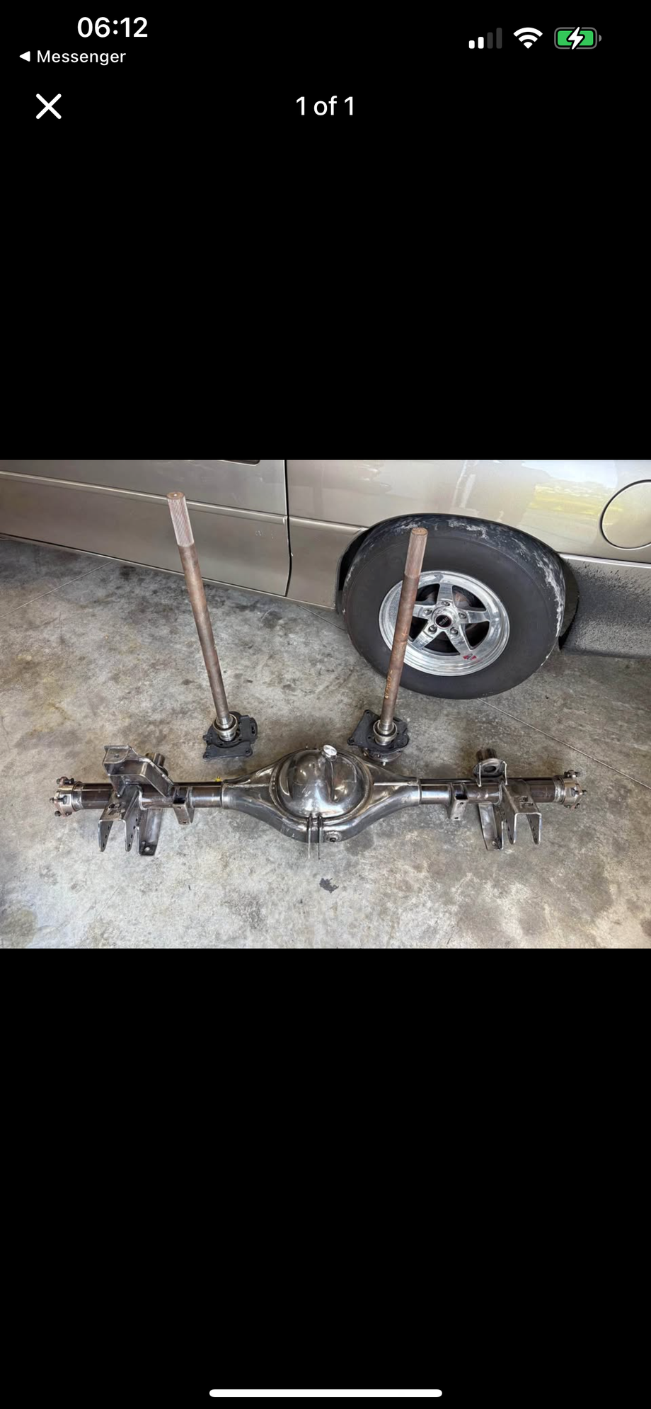

Can anyone tell if this is a Hawks unit or a diy?

Plenty of LSD options for either rear. S-trac, tru-trac, ect.
