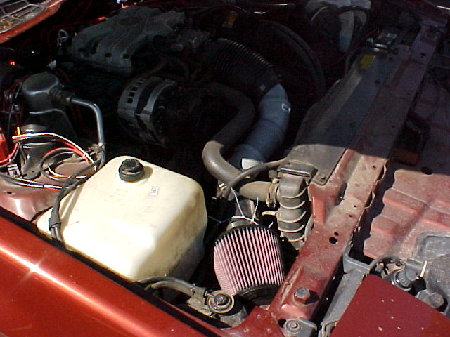

KN filter about $35
hose clamps free
plumbing sections about $7
short piece of rubber hose free
measured available area for filter and found best match on KN site. cut the sharp bend going into maf off. temp sensor hanging for now. Then just make it all fit. secured with zip ties (for now).
Next step isolate filter area from rest of engine bay to keep out hot air and funnel some fresher outside air in.
course with a camaro you might have to do something different, but you get the idea.
