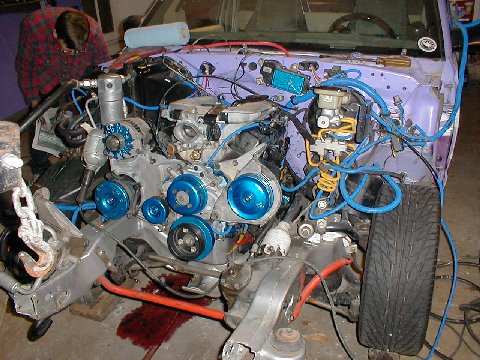

Well, camaro issue first. Got woke up to car doing same BS it has been, but this time it was completley cold. So I finally got a chance to trouble shoot it when its acting up. I tryed the old pull plug and lay it on ground and crank car, NO SPARK. Come to find that 1 white wire to the coil was not reading properly. So I went to patch that wire, and behole 3 of the 4 wires to the EGR are freakin melted. So I patched them too, reset ECM and as of now, its running. Keep fingers crossed!!!!
For the non-camaro stuff, I was asked to inform some of you how my engine swap is going, I think the picture I will attach will be self explanatory

nice pic!!!
but who's blood is that on the floor underneath? Or if you told us, you'd have to kill us?

No blood tonight, just forgot to drain tranny fluid
However, I have never seen a drain plug on the tranny.
VERY TIGHT FIT, around the AC pump, but it shall work
