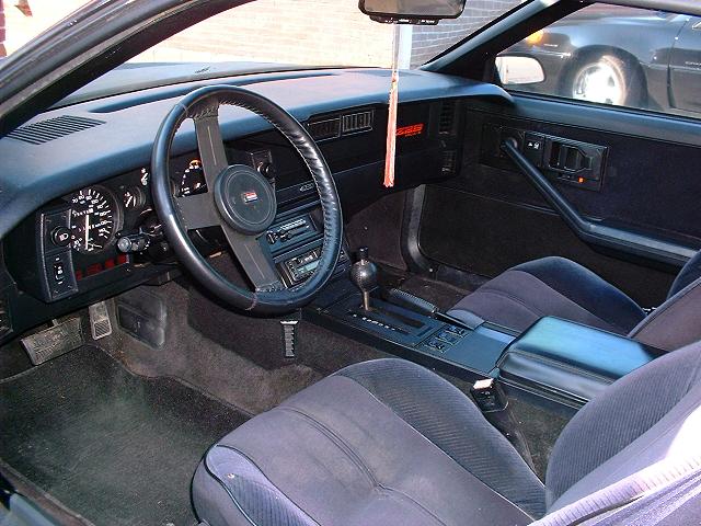

The shift **** i want is this one ..
https://www.thirdgen.org/techbb2/att...?postid=858569
http://www.thirdgenparts.com/ebay4/85leathknob.jpg
But i think only the square type ones will work..

Why do you want the 8 ball ****? Ok, it's leather...that adds to it a little..but I saw a plastic one of those on a 2.8 and it was the ugliest thing I've ever seen!

I just like the looks and feel of the 8ball **** (leather or not leather dont matter) plus i have a manual shift plate so it would go real good with it.
