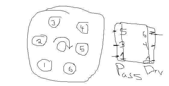

Hey, I got this engine and none of the spark plug wires on the right side of it are plugged in, the left is good, but i have no idea about the right. Does anybody know of some way to get the wires to the correct plugs other than just trial and error.

Ok this is a simple one. This pic will explain it all. You just need to find out what wire is the 3rd spark wire and trace it back to the second wire and run it to the #2 spark plug ect and ect.

Thanks
