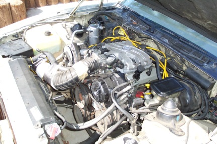

Check out pic of the hokey air inlet set up.
I use several items to get desired effect of better air entry & boy does it work very well.
BECAUSE I BOUGHT A CAMARO CAI SET UP COMPLETE THAT IS RESTORED AND AVAILABLE INCLUDING AIR FILTERS & THE BOTTOM PIECE THAT HAS AIR FILTERS AND HOSE TO THROTTLE BODY. IN MINT CONDITION
That item is restored and it looks brand new & shiny correct as if from dealer. It goes up on ebay later on after I finish restoring this house I bought & the next one I buy (then back to retirement!). I'll send ya a pic of Camaro version CAI if anyone like to purchase. Top & Bottom piece, air TB hose, air filters, not cut up, restored.
I'll have to include other pics of other items I used for my Firebird air entry set up.
I found the 90* bend from throttle body at a swap meet & paid one dollar for it.
I used 3" flex dryer hose to mate the MAS to 90* bend.
BOY DOES IT LOOK HOEKY!
YET IT WORKS SUPERB.
