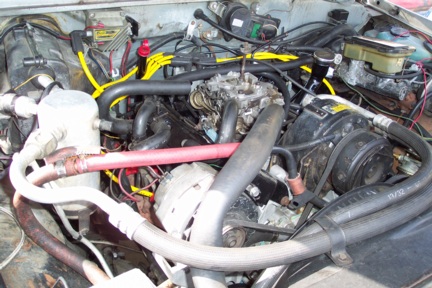

Here's my 1985 Federal version S-10 Blazer with a 1995 Camaro 3.4.
I do only CA Smog Legal conversions.
Hope this is a guide for ya
