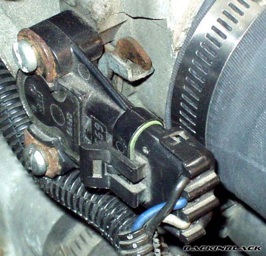

The TPS is attached with 2 slotted tabs. Screws go into the TB, and you can loosen the screws and rotate the TPS.
What model Fluke do you have? I have the 179... Great meter!
I'll take a pic later and post it up here to hopefully clear things up...

Here's the pic:

I apologize that I cannot seem to get my pic uploaded... I'll try again here...

coool can you take one to show what the tang looks like on the sensor if u can
Old May 22, 2003 | 06:19 PM
BackInBlackGP's Avatar
Posts: 344
From: Vermont
Car: 1986 W69 Special Edition
Engine: 2.8/ECM/Int/Exh
Axle/Gears: 3.42 posi
Like this?
Old May 22, 2003 | 07:31 PM
89 firebrd's Avatar
Joined: Aug 2002
Posts: 44
yes perfect! that part that is resting on your throttle body shaft is the part i bent up kinda like the other side of the tps is the only way i could get it in spec was out of adjustment the way it came new i will post a pic this weekend to show you but mine looks exactly like that except for the mod Is your a v-8 or 6?

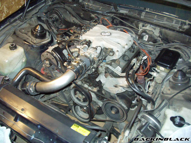

The TPS is definately adjustable. I've done it many times...
Do a search on how to adjust the TPS, or you can use my procedure for the 2.8L that I posted above...

Yep, the GM Shop Manual (or GM Service manual, however you want to call it ) was the first thing I bought for my car- back in 1994!
Yeah, adjusting the TPS is a no-brainer; be careful on the metal screws for the TPS, though. Don't muscle 'em; they like to snap easily. Remember too that you're squeezing a plastic "tab" between the screw and the aluminum throttle body- so don't overtighten the screws!

If the TPS is not adjustable from the factory you can make it adjustable. But unless there is a real reason to, this may cause more harm than it's worth.

If I check the TPS at WOT and it gives the right reading, does that imply that the TPS is set correctly everywhere?
Old Aug 1, 2003 | 12:18 AM

So the engine gets started while the ALDL connector has the jumper (paper clip) in it?? I thought that could damage the computer...
Oh and don't adjust the TPS at WOT. Adjust it only at idle. The computer will know when to engage PE mode after a certain percentage "above" idle speed- I was told anywhere over 4 volts is enough, even though the GM book says 4.50 at WOT. Most I could ever get mine set (while obeying idle voltage) was 4.28 volts.

Minimum idle isn't really dependant on the TPS... do the TPS after you're done with the minimum idle (I guess if you want to make it a step, make it step #7.)

Well, lets say you adjust the tps from .50 volts to .56 like I did today, the idle suddengly jumped to 1200 rpms even after I disconnected my hand held scanner thing. So, I shut her off, unplugged the batt for 5 mins. After plugging it back in and then restarted her, it idled fine again. I figure it's a good idea to reset the computer anyway so it can build proper values based on the new set up of the TPS.

question on checking the TPS with a VOM... with the volt ohm meter, how did you connect it to read the voltage? i read somewhere you make jumper wires? i cant find out what they mean by that, or where to connect them. my understanding from reading the tech article was just touch the pins of the VOM to the unplugged TPS on the throttle body, and that would read the voltage when the ignition is on? or am i supposed to somehow touch the wires in back of the plug itslef to get the voltage?

On other vehicles that I havn't had a handheld scanner to use to read the values, I have been able to backprobe into the plug itself. Been able to do that with certain types of o2 sensors (the ones with two or more wires), and the tps.
