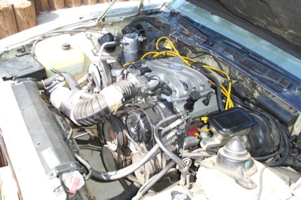

Try to find the CASTING DATE & SEE IF
it corresonds wiht the build date of your car.
I'll bet ya got the same engine still.
PLUS you having an EXPORT CAR, things COULD be ever so slightly different.
Here's a pic of a 1995 3.4 Camaro engine under my 1985 Firebrid induction/ignition system.
I do not know where to find your block casting date with out a lot of effort for no reason. What ya need to cure is teh engien shakes, not when teh engine was built.
The engine is "sick" & needs proper diagnois, not proper cast number/date identifcation.
Thes F bodies can only use a RWD 60* engine, nothing else.
ONLY RWD 60* mills came in S series trucks & F bodies passenger.
