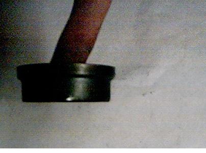

We could have ended this conversation a long time ago if we had some pics of these stupid things.

Pics of te stupid things (yes, the nice solid metal ones from the 2.8):

Okay, I'll have to swipe a cam from a friend and snap a pic of the two side by side. The ones that Project 2.8 have in the pic are the ones that caused my leak by being way too large. On the other hand, I have one of the smaller ones waiting to be put in (I have to drill and tap a hole for the new stud on the driver's side manifold) that I will take a pic of alongside the others. Oh, and if you notice in the above pic, where exactly do the donut have a place to seal the exhaust? They don't have anything that will sit inside the manifold and allow the gases to pass through the middle of the donut, now do they? That's basically like using a steel plate bolted to the inner hull of a submarine, without any sort of gasket or sealing device- it STILL LEAKS!

They seal metal to metal, just like the exhaust manifold to the head. There is no gasket needed for that (until you pull it, because it'll never seal back up like it ws before )

Second, the side view of the newer donut by itself:

This is the insert to the newer donut. The wide end is the end that goes inside the manifold:

Side view of old donut. Notice that it is almost as thick as the entire new donut is with its insert, causing somewhat of a problem on my car:

Just ran into this problem myself. 31550 are too large.
The part number for anyone else having donut gasket problems on at 2.8 V6 use
FELPRO 60538. These have the metal inserts that go into the manifold and also have soft material that the y-pip flange sits on.
This part number is good at advanceauto and autozone.

Be careful with those... There was a guy on here who had an engine fire because the pipe wasn't aligned properly and the exhaust gases leaked out against the wire harness...

heres a lil trick for u guys , when installing the donouts get a bottle of antiseize and coat the donout with it then install it.
the antisieze will smoke a lil bit when u first start it but as it gets hotter it turns into a solid paste sealing everything up nice and tight
