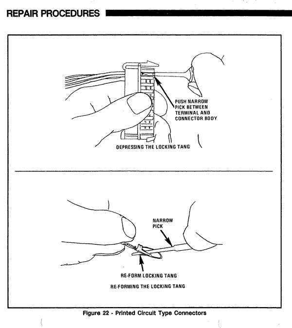

The wires that hooki into the connectors for the gauge cluster. Whats the trick to getting the wires out of the connector?

the little tab should push out thru the back on those attached to the wire

Take a small thin screw driver and push in from the front side to unlock the tab on the pin and then pull the wire out the back. Sort of like in this picture.
