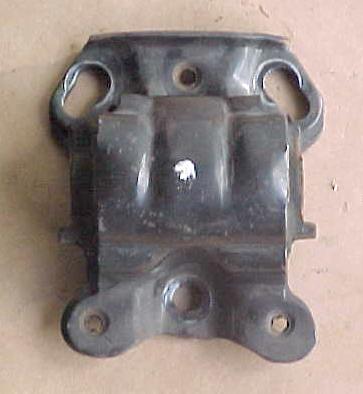

Pic... k-member side of motor mount.

autozone.com says 91 and 94 take same mount.
No poly one listed. I belive WAY down on dowards list was a conversion of using v8 poly mounts, and custom brackets to mount a v6

Yes, that is correct on the Poly motor mounts.

I assure you, the mounts on a 3.4 are COMPLETELY different from a 2.8L/3.1L. I have 3 pairs lying around, they have different geometry than the ones for the 3rdgens. the mounts on the K-member are different as well. I'd take pictures, but my Cmaera moved out of my house (Sonar).
