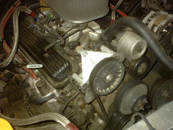

Sorry, I just read this for the first time. I have a Factory Camaro A/C delte pulley on my truck. I'll go get the part # off it and take a picture of it. It will work on either a V8 Camaro or a V6, they are the same A/C compressors.
Old Dec 30, 2004 | 12:20 AM
vsixtoy's Avatar
Joined: May 2004
Posts: 1,340
From: Orange, Calif
Car: '87 Cam RS V6
Engine: Top Secret
Transmission: DYT700R4 custom inerts and conv.
GM has this labeled as a waterpump pulley- it is not such. It cam on factory IROC's that had no factory air.
It is GM part # 10055890
Imput that part # on this site
http://www.gmpartsdirect.com/results.cfm
Here's a shot of it on my work truck ('89 350TBI)

Yeah but, isn't the way it mounts different then the v-6?
Yes, but it works identical. It just on the opposite side of the motor and it mounts right side up (not upside down like on my truck)

So I should be all set if i go with the V-8 AC delete pulley? And it doesn't matter how it is mounted? Thanks again man

And will the orginal belt still fit is the question?

It should, the pully is the same size or should be at least as the a/c pully. I had heard a rumor that you could use that delete pully in place of the smog pump as well, that true? My smog pump is currently hollowed out but I want it off the car and I can't just get a shorter belt as it will rub.
Supposedly you can just get a shorter belt and bypass the a/c but it didn't work on my 3.1, th ebelt rubbed on the top of the water pump pully.
