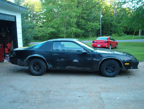

Haha....you're kidding, right? You can't see any of the dents in these pictures because of the flat paint, but there are large (body-sized) dents in each door, rear quarter, and the passenger's front fender.
You got any pictures of your car? What it looked like when you got it and where it's at now?
I redid my '84 over last summer. Started with a structurally solid car with rust around the rear lower edges and bottoms of the doors, and smoothed it out into what you see here. I doubt I can do the same kind of job with this '88 without having to spend a whole lot of money on new sheet metal.

this is what I started with. You can definitely see every spot there was once rust. Other side wasn't much better.

No kidding. I do have some before pics, but I don't have any after pics yet.
That black Camaro looks GREAT. What did you do about the rust? New metal, or rust treatment and body filler?

Yeah, I treated the rust with that converter fluid after sandblasting the hell out of it, and then used polyester filler and glaze. Seems to be holding up well. I'll likely weld in some new metal pieces when the rust starts poking back through again in a couple years, when I'll have more money to play with. Thanks for the compliment, too.
