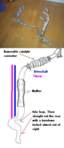

Old Feb 27, 2005 | 12:19 PM
RTFC's Avatar
Joined: Jan 2005
Posts: 1,238
From: Yes I'm Dean
Car: Agood2.8,
Engine: V6rsr,
Transmission: Afrikingoodtime
Gumby,
How much louder than stock is it? Would it compare to say a flowmaster 80 or a Dynomax in noise level or anything else you are familar with that you car compare it to.
And how is it holding up after everyday use- Does it appear to be any louder now than when you first installed it? I think I remember you installing it about 6 months ago.

It sounds great. I did have problems at first because I welded it in solid. And the new metal would ting n pop when hot. Started quenching the muffler with water after a drive to shock the metal & It finally stopped. But that was only cause of it being welded.
Though it really does sound good. No whiny V6 sound. I often will just drive around to listen to it. Has very good deep sound.
My stock system was annoying when you started rev'in it out.
around 3000 it gave it away as a V6.
No V6 clues from the sound now.
Also I get very good flow. This mod came about really as I fixed 100 holes in my stock system and noticed it didn't rev as fast in the higher band. That muffler solved my problems. Rev's free and easy.
That was really why it was done. So it would rev as fast as it did before but with a good leak free system and the stock fake dual muffler just couldn't do that anymore.

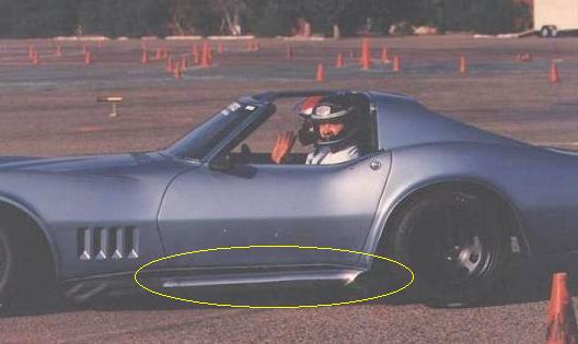

This is where I am looking to position a muffler. I want to get rid of the heavy rear Flowmaster dual setup and just route a single 2 1/2" turndown as diretly toward the back of the car as possible making the entire length of the exhaust path from motor to the rear of the car as short as possible to help flow. This wil also take heavy polar weight of the rear of the car for better corner transitioning agility.
I want a high flowing- long lasting- not any more noisy than a Flowmaster 80 exhaust insert or muffler that I can fit parallel to the driveshaft section of the exhaust and after the catalytic convertor.
Attached Thumbnails Glasspacks on a V6-c-documents-settings-office

With that much tail pipe it will probably be very quiet but still flow.
I have the same muffler on my wagon. and its similar to your pic. And it very mellow but deep. And of course flows like a dream.

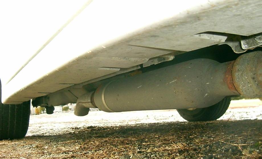

You've got a very good point. I did runglass packs that burned up right after the headers on a car that spits flames out the headers when uncorked.

Yea it will burn n blow out on a car or install like that.
Ya need one of them supertrap mufflers. Real pricey race muffler that comes with removable disc to adjust BP and tune the cars sound.
Very nice. No parts to wear out or rust. Completely rebuild-able.

heres mine, it sounds alright at idle and at half throttle but boy if i get on her it sounds horrible. Its like a fart cannon sad to say. but it sounded way better out the back of the car, the way i have it now it rattles everything in the car. I dont care too much about it, the v6's going soon and all that crap is with it
Attached Thumbnails Glasspacks on a V6-c-documents-settings-sean

Oh yea. Ya gotta get the sound out from under the car to enjoy it right. Other wise it does just rattle your brains.
Had a 72 Charger like that once. Headers and dual glass packs ending right under the back seat floor. Everyone said it sounded good. I had no clue as I was deaf past 1/4 throttle.
