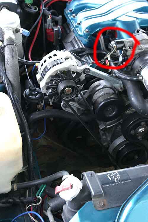

I think I fixed the problem.
If you look at this picture https://www.thirdgen.org/techbb2/att...postid=2663340
Under the IAC, is that the TPS that is in the bottom of the red circle? It has something shaped like a circle plugged into the side of it... I had the car running and I unplugged it and it didn't idle any different, I stuck it back in and when I did I pushed it in hard and it started idleing normal again. So what I'm thinking was somehow it wasn't pushed in all the way causing it to idle high, does that make sense?
Old Jan 3, 2006 | 04:49 PM
Naft's Avatar
Joined: Oct 2004
Posts: 539
From: Chico, CA
Car: 89 Firebird, 92 RS
Engine: 2.8L MPFI, 355 TPI
Transmission: t-5, t-5
Axle/Gears: open 3.42, posi 3.42
yep
Old Jan 3, 2006 | 07:05 PM
Doom Sayer's Avatar
Joined: Oct 2005
Posts: 205
From: Richmond, VA
Car: '06 Nissan Sentra SE-R Spec V
Engine: Big block 2.5L
Transmission: 6 Speed
Cool. I fixed something without knowing what I was doing
