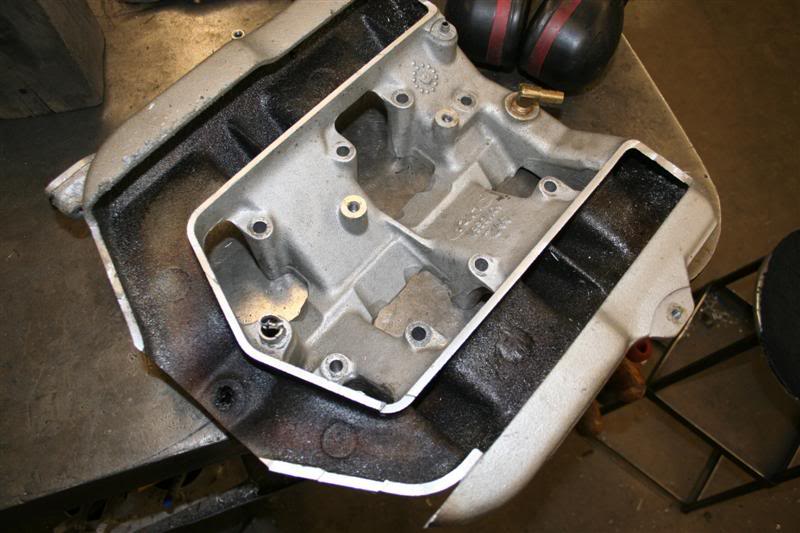

Originally Posted by oxrabidus
im just curious... would there be a difference in power? how much if so?
thanks for the info guys.
I thought I had heard once that the 3.4 UIM is had worse flow than the 2.8/3.1...but I dont think that many have tested it. I think it was something about how the intake gets skinnier near the back, and the back runner/s not getting equal air...but like I said, Im not 100%.
Although even if Im wrong, I doubt that the increase would be noticeable.
Found this...

Old Jan 2, 2009 | 07:03 PM
oxrabidus's Avatar
Joined: Sep 2007
Posts: 517
From: Orlando, FL
Car: 1989 Camaro RS
Engine: 2.8l v6
Transmission: 5 Speed Manual
Axle/Gears: Probably the stock 3.42
Re: just a simple question...
i will do it and see. plus... the 2.8l intake is prettier...haha... it will be stock minus headers cat back and no cat... either way it will definately be better and more reliable than my 2.8... its about to go... and this one i got only has 80xxx miles on it...
