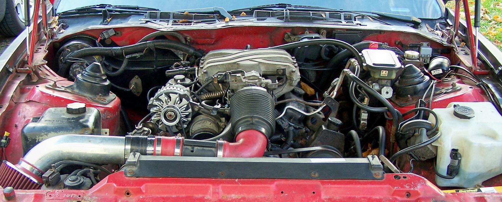

That's doing it the costly way... It's even easier (and less expensive without having to buy an A/C delete pulley) to just get rid of the compressor, brackets and all. And then you can take the aluminum from the condenser, evaporator, and the compressor bracket to a scrap yard and get back some of the cost for the replacement heater box and belt.
Like this. I found the A/C delete box hanging almost loose (except that one freakin' bolt ) on a completely unoptioned '84 4-banger Camaro, that I got my replacement door from. Luckily the fan motor still works even though I'm sure it got wet a few times in the rain (blasted thing costs TWICE as much as an A/C blower motor!)...
:edit: BTW, where is it $150 for the heater box plus fan? Got mine for $30 WITH the fan (new motor that's going in is $35 though).
