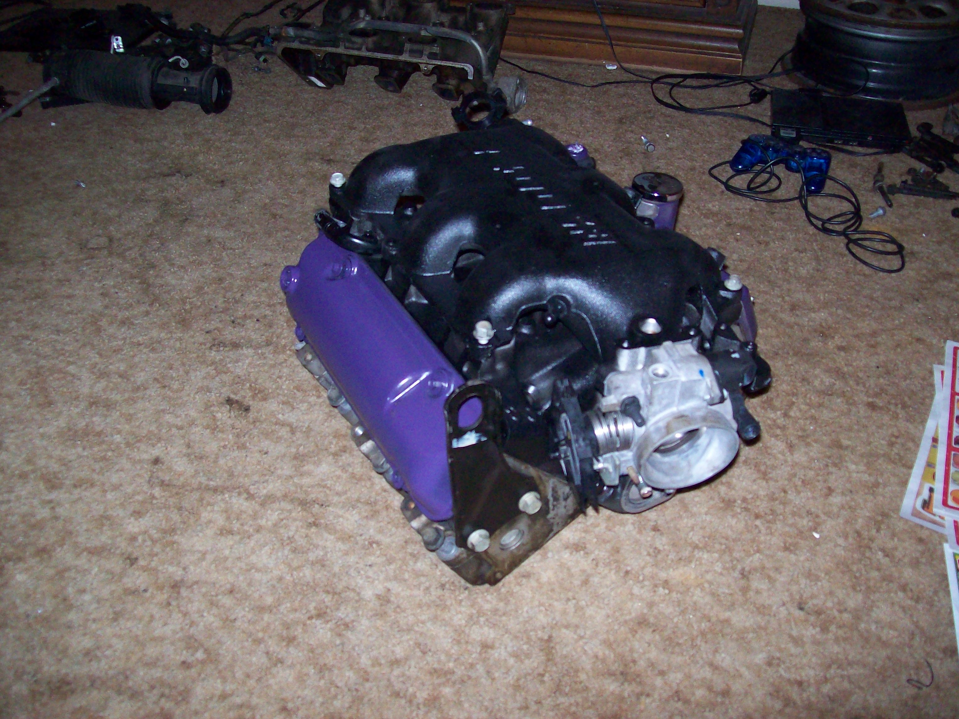

I painted my plenum semi-gloss black, and painted my valve covers purple, also I have a chrome oil cap, going to put a chrome radiator cover in way down the road, and probably some other stuff. Headers always look good, I'm also going to paint the cylinder heads once I clean them up good, haven't decided if I'll use the black or purple on them though, but probably the purple(esp since I don't have much black paint left, might run out...), heres what it looks like so far, also bear in mind I'm building a hybrid...
Oh, and the purple is fairly darker than it looks in the pictures.
Attached Thumbnails v6 appearance-100_0294.jpg   v6 appearance-100_0293.jpg   v6 appearance-100_0296.jpg

that's a really cool plenum... where did you get it?

That would be the plenum off of a 3400 :P
3100s also have them, albeit the pre 2000(year) ones are a little bit smaller internally.
And some of them have lines going across like this:

and they fit a 2.8? or do you not have a 2.8 anymore?

Hehe, I'm in the realm of the hybrid, they do not fit on a stock top end, you have to swap over the whole shebang, 3x00 heads, and LIM to be able to put that plenum on. And yes I'm retaining the 2.8 block, putting 3x00 top end on it is the equivalent of getting the best porting possible on your stock heads and manifolds. Or compareable to what aftermarket would be like, and of course if you port the 3x00 top end its going to blow away the stock iron heads.
The heads and manifolds themselves are direct bolt ons, but everything else gets complicated, especially if you're unlucky enough to have a distributor ignition =/

They don't fit without a head swap, the 3X00 swap as it's known around here.

6 45mm throttle bodies all linked together and bolted to the top of the runner. I've seen a lot of Honda guys do the same thing with motorcycle carbs but this one is a 1-off fully CNC'd piece owned by Marc from TCE.
Some day i'd like to run a similar one on my 3.5 but for now i'm using the stock one..
Here is mine when it was in the Cavalier, it's a high flake Gunmetal color.
