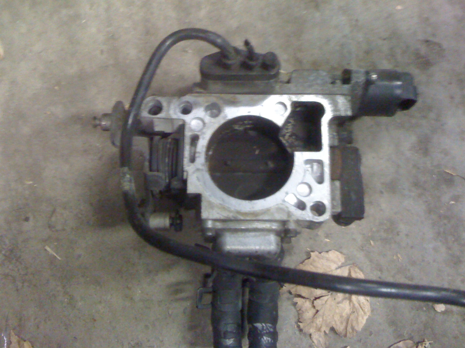

I need a new throttlebody, apparently my TPS(no I cannot just replace the TPS...don't ask.....) has been causing me my issues...I have one off of a 3400 I could use, problem is I have no idea how to deal with the TV and throttle cables, or the IAC passage, instead of a nipple fitting for a tube its a square hole....and the throttle lever would actually be on top in order for it to bolt up...if anyone has some creative ideas here I'm ready to hear them....

pics of 3.1 tb
Attached Thumbnails need new Throttlebody, or help retrofitting a fwd one..-tb-1.jpeg   need new Throttlebody, or help retrofitting a fwd one..-tb-2.jpeg

along with the 3.1 tb he would need the iac pigtail and the rubber/plastic elbow that comes off the pcv valve along with any connected vacum lines.
2.8 tb uses a tube to allow the air the iac lets in get to the manifold base.
3.1 tb the iac dumps that air in behind the tb butterfly
both use sligtly differnet vacum system hookups, but interchange if u get all the related parts
but one word of advice if u r using the cold stat injector still switching to the 3.1 tb and vaum system will not allow the csi to work properly
