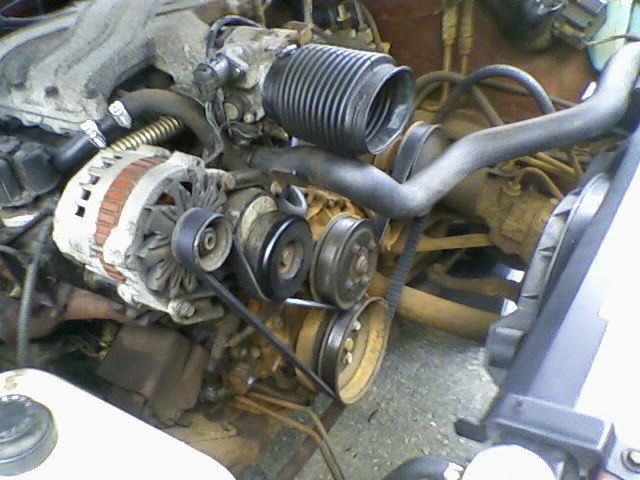

ALSO AS for the AC AND A.I.R DELETE! yall do realize its a 90 and im running a serp belt not v belts right? leme get u some engine pics, its all stock cept new injectors

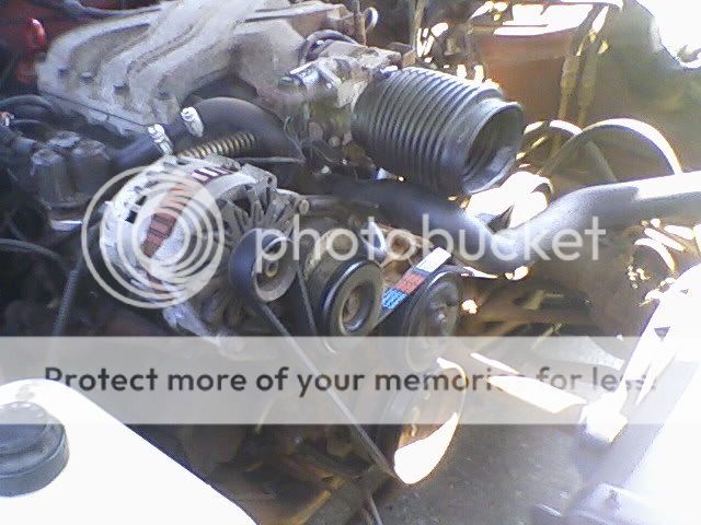

my tensrioner is at teh top by my alternator, my ac comp is on the drivers side above the power steering pump, smog pump is under the alt. im tryna figure out how the belt is gona route with teh crap missing???
is this how it should be routed???? foudn this pic on google NOT MY ENGINE

corect me if im wrong but theres very little clearance between the water pump and the belt going from the ps pump to the tensioner,, bout 1/8th inch of clearance,,,,thatsss uuhhh not enuf is it...
i drive it every day soo yeaa

this is what i have now, and so far what iv read, if i use n 82.5" belt i can just bypass the compressor and smog pump corect??
as for the compressor and condensor and line removal i got all that, now im onto the bypass valve and all that crap on the pass side of the engine, since no a/c i dont need it right??

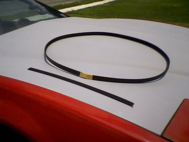

Pull the smog pump off entirely, and cut the stock belt open. Run it around the way you want it by hand, then when you have it the way that you want it, cut the excess off, tape it up, and bring it to an auto parts store and have someone find a match for it. This is where and how I cut mine, how much I cut off, and the finished product....
that way spins the wp backwards
run the belt like normal except u go from the ps pump to the alt

Originally Posted by project89
that way spins the wp backwards run the belt like normal except u go from the ps pump to the alt and from the alt down to the crank...
It doesn't spin it backwards (clockwise) that way, it's just routed differently. The correct and secure way is to wrap it around the waterpump like this, but the waterpump still spins counter clockwise either way you do it, which is the correct way because it is the serpentine setup. This way is just the more secure way to do it...;
And that's the way GM did it... I've seen a factory A/C delete car this way...
And the pic under the cut belt above shows the bolts in the PS pump bracket I was talking about... Just above the middle curve in the upper radiator hose is the bolt in the A/C position... Put the bolt in the hole next to this position to allow for the A/C delete with the proper 81.5" belt.

yea i see teh 2 holes in the braket, is it as simple as just losing one on the water pump, takin the other out, and moving it to the next hole?????

I pulled my AIR pump and have the belt routed the exact same way. I tried to get the part number off it, but its worn off. the way i measured for a belt was i took a piece of string, routed it that way, measured it then took off an inch for belt tension. not positive but i thought the belt size for a car without A/C and without AIR was in the 72 inch range. it make take a couple of tries, but hey, the parts stores take returns. so maybe just buy a couple right around that size and return the ones that dont fit snug.
EDIT: I just checked napa's site and it shows an 825 part number, so it looks like it would be an 82.5 inch belt.
This is exactly how I have mine routed, still have the pumps attached too, need to find a free day to pull em off haha

also why do you have to move the power steering pump?? I didn't touch mine and the belt routed just fine
