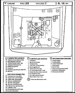

In the intake manifold? Would i have to remove the manifold or is it easy to reach without having to dismantle anything? And could you maybe show me a pic of where it is and what it looks like? i want to make sure autozone isnt selling me a sender or something other than the sensor.

Re: Are the coolant temp sender and sensor the same thing?
Thank you. I see which one it is now. Its the one by the thermostat housing. Ill replace it and hope for the best. Thanks for the help.
I replaced the sensor by the thermostat housing (it broke in my hands while i tried unscrewing it by hand so i knew it was bad). The code 15 (coolant temp sensor) is gone and even my code 34 (maf sensor) is gone too. Im relieved because the maf sensor ir pretty new and they're not cheap/ i got a different check engine light that comes on while i drive but ill look at that later. Thanks you everyone for your help.
