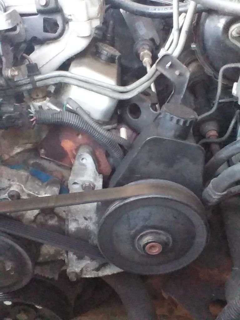

I have a 2.8L v6 1985 firebird S/E. I took my old pump off because it was bad. I was planning on buying another one but had to spend the money for the new pump on other parts. I finally got a new pump but now i cant remember how it bolts up, was wondering if you could post pics of yours to help me out. Thanks.

Pumps on an ally bracket that uses on of the head threaded holes and one on the water pump. Also has a small bracket on the back that mounts on an exhaust stud.
