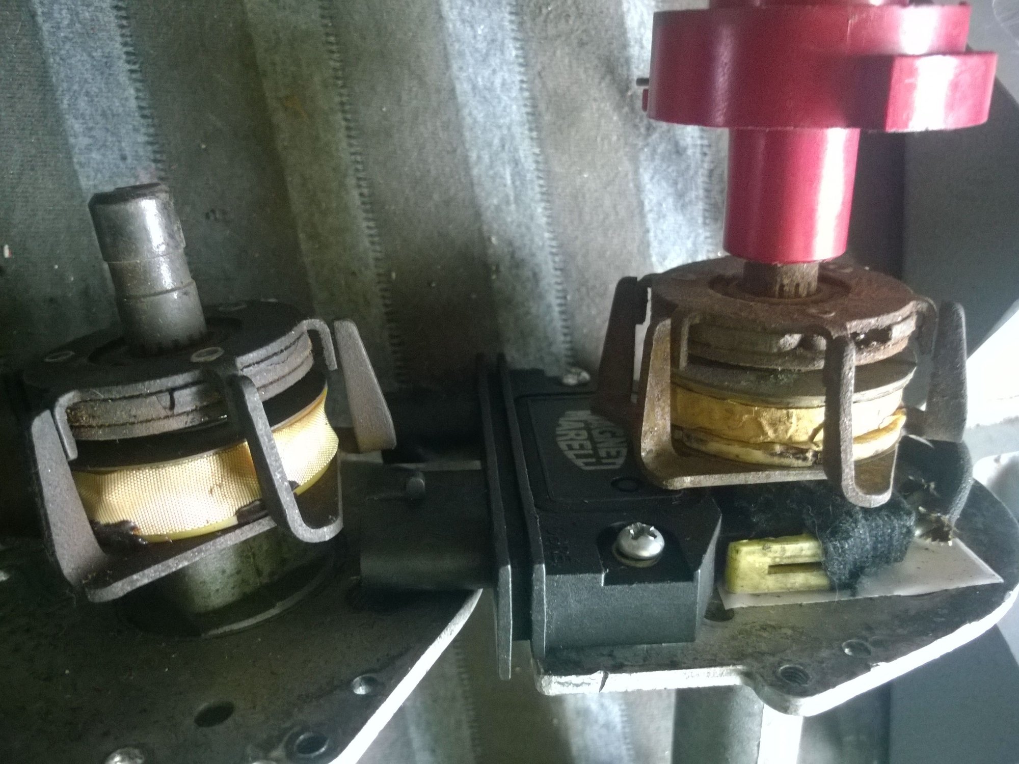

Today I noticed the big cracks on the magnet in distributor, but it's happening the same on the secend one (left side) with small crack-but it's cracked alongside, Could it be this? Can I buy this part of the distributor somewhere, because I can't find it on Rockauto

Have changed whole distributor with new module... didn't help...
