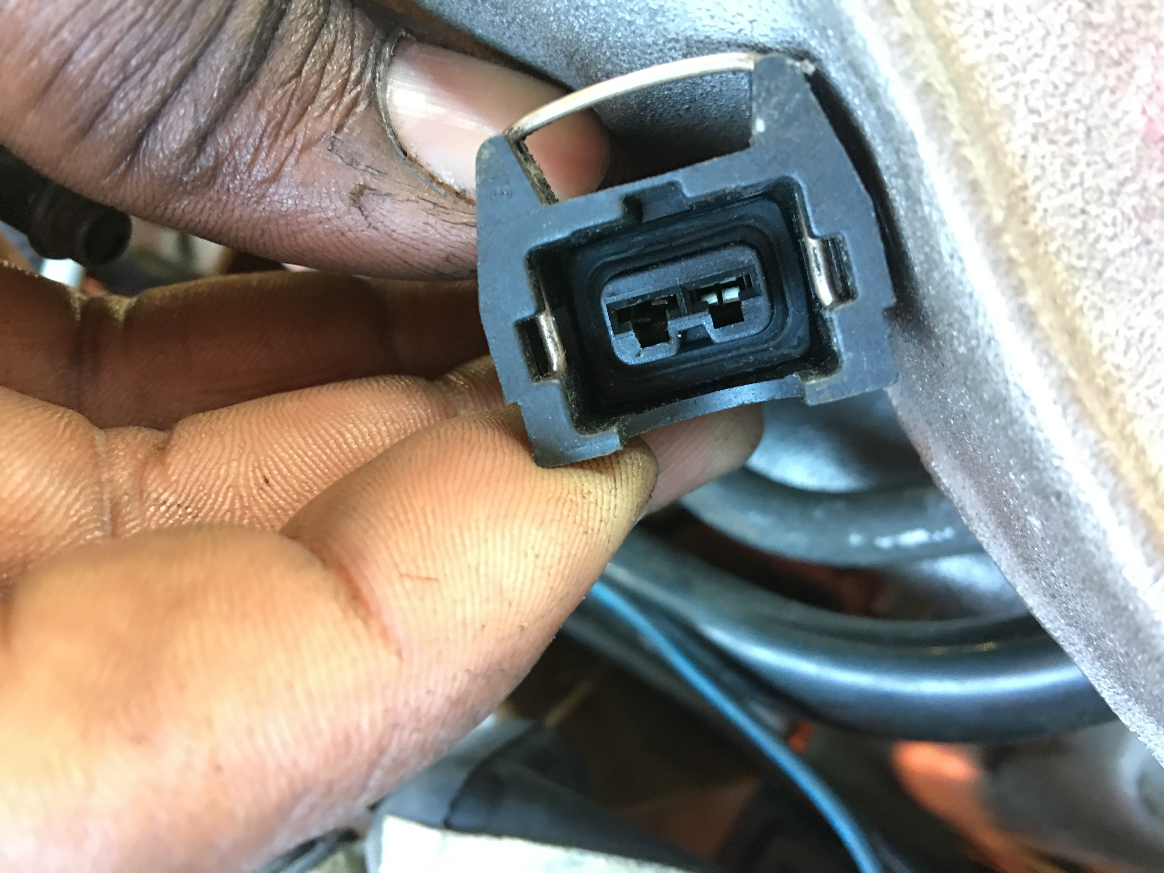

I have similar symptoms but I found my #5 cylinder is dead as well. Everything in my ignition system has tested good or been replaced. One older mechanic told me about something in the ECM not sending proper signal to the injectors(which are new as well). Any ideas?
Old Oct 24, 2016 | 07:19 AM
Six_Shooter's Avatar
Joined: Mar 2006
Posts: 4,370
Likes: 19
Transmission: 5-speed/T-5
Re: issues with tack jumping
The fact that at the very least 5 of the injectors are working means that the ECM is not the problem the ECM you have would be a batch fire system that fires all injectors at once. IIRC the 2.8 ECM has only a single injector driver, and two connections that connect to 3 injectors each. So your problem will be outside of the ECM. Check for signal at the injector a noid light is best here, a small incandescent bulb cab be substituted though, check the injector and do a mechanical check on the bad cylinder to make sure it's not an internal failure.
Got it figured out. I always forget to check the easy stuff. Thank you though.
