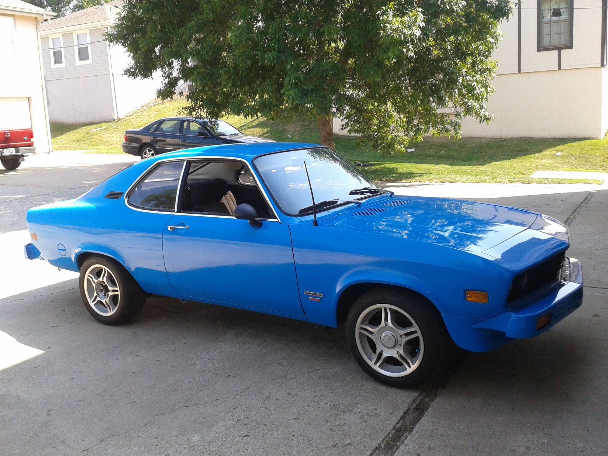

Here are a couple pics of my Opel GT.

Very nice Opel. Don't see those everyday.

The swap looks good and clean.
