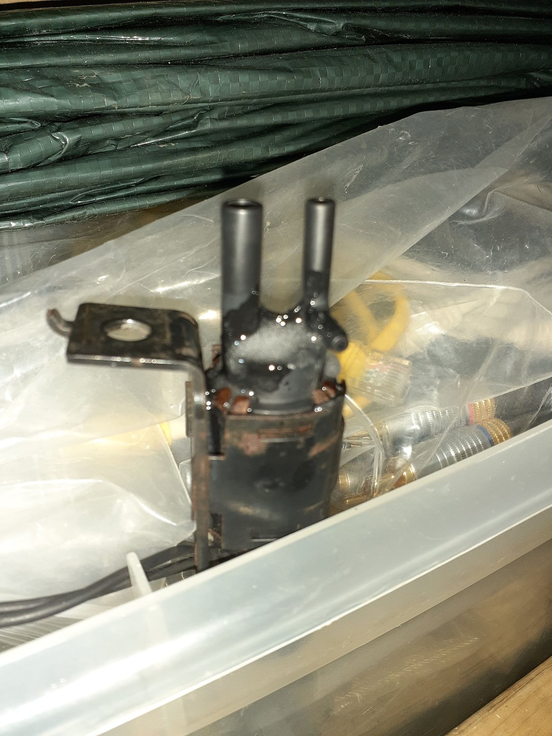

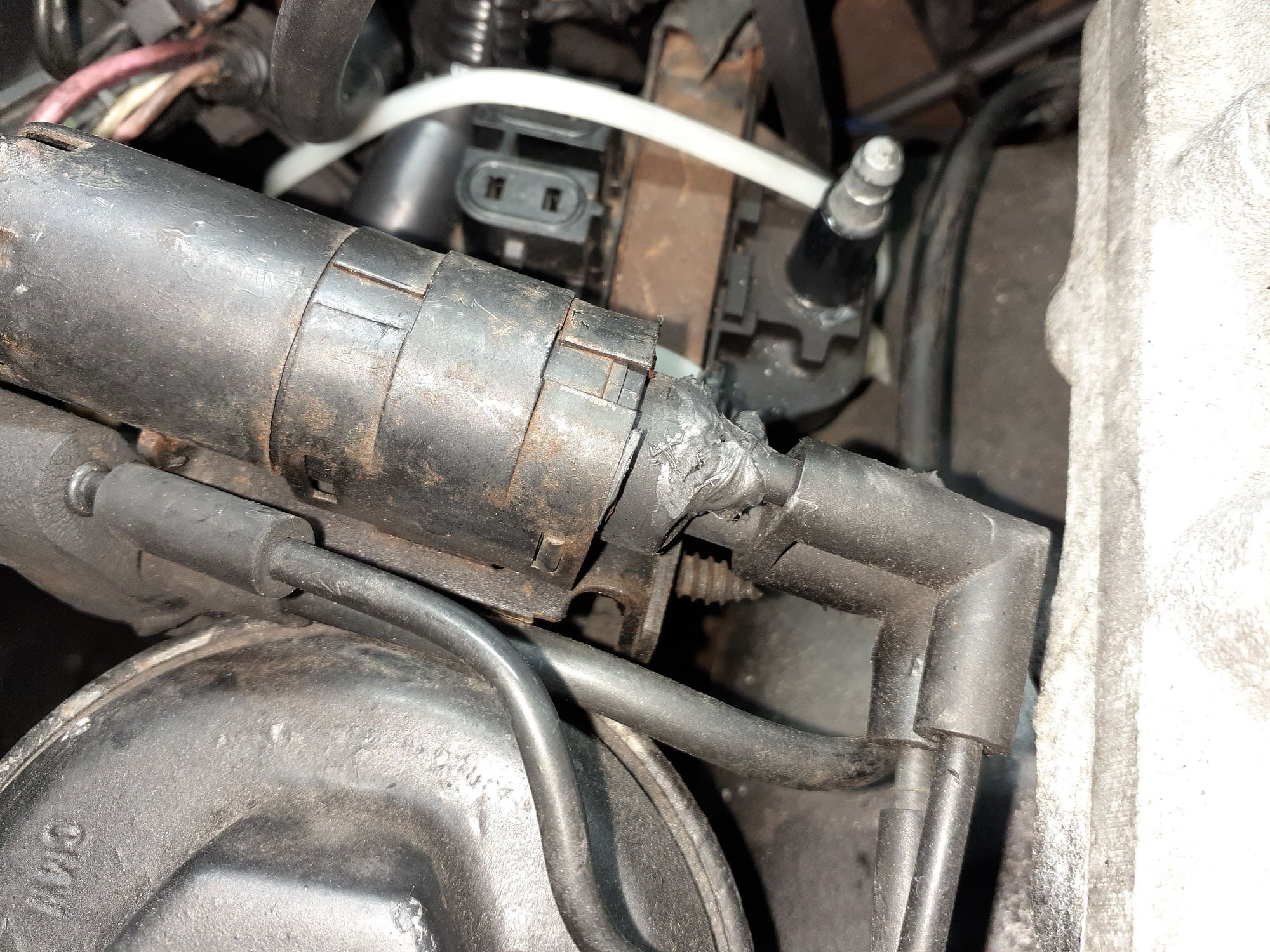

Problem mine had was very similar with my 2.8 L V6. After a great deal of headache, I found the small canister the vacuum line from the throttle body went to was broken: where the line attached and starving the fuel pressure regulator of vacuum. Someone had previously used gasket sealer on it thinking this would hold. I used a strong two part epoxy to fix it. I now have full acceleration again. Key-on fuel pressure was 40 lbs. and holding when tested. With the vehicle idling and giving it gas, I could watch it stumble erratically on my gauge. I know the previous owner had the injectors and tank and fuel pump changed and this damage likely occurred during the injector repair. Canister mounted to ignition coil bracket with 10mm screw.
Cracked at the base and sealed with sealant.
Cleaned thoroughly and epoxied
Re-installation
