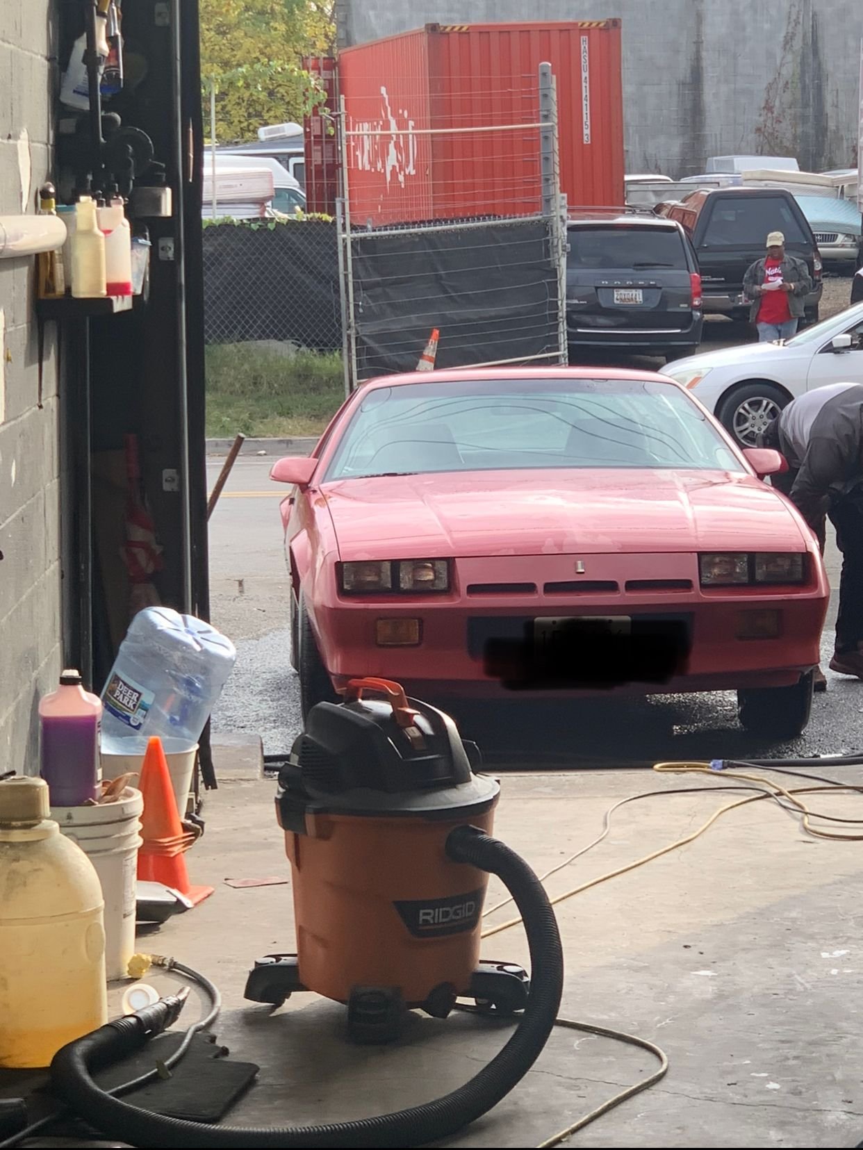

I recently took my my baby in for a tune. I have a 84 sport coupe camaro. She was running sluggish, but still ran fairy smoothly before I took her in. Mechanic changed rotor, caps, wires, etc...& said the plugs where still good.
Got to the oil change & put synthetic 10w30 oil in the car to start. Bad idea ! When I drove it down the block from the shop, she started running rough. The tech suggested going to get some Lucas oil stabilizer and some 10w40 regular motor oil.
Came back and added that to the mix and she is still unhappy. Now they say I need a new oil pump at minimum. I don’t want to screw things up any more than they already are and I need help getting to the bottom of things. Any help is appreciated ! Ive read some things about rotella t oil but that’s for diesel. some that say 10w30/ 10w40 is fine for my car but it clearly isn’t working.
