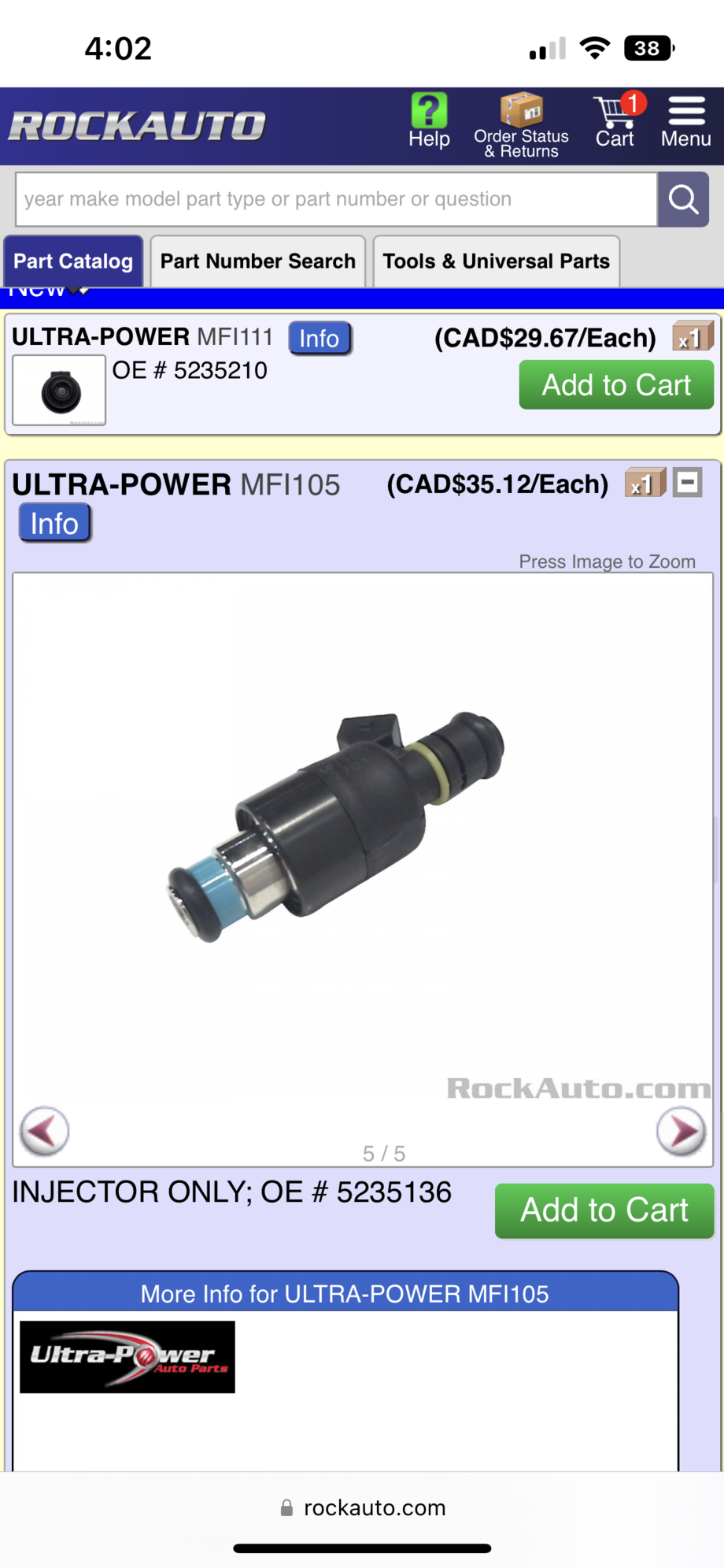

This weekend I replaced the injectors with new ones off rock auto(not remans; new units), and did the thermostat. Now I have an intermittent rough idle when warm and check engine light at idle. After I start driving, check engine light goes off.

I still seem to be having a hard warm start so, my thoughts are either bad cold start injector which is constantly leaking fuel into the engine while it’s running causing rich code, or one/multiple of the new injectors is faulty and is causing the engine to flood out.
