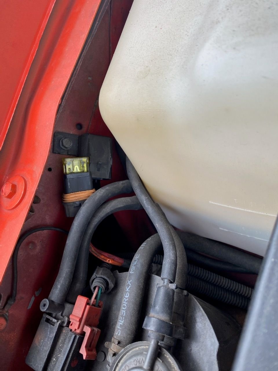

Re: 1986 firebird fuel injection, injectors not working
Originally Posted by Ibrahim12..
Got a firebird that doesn’t start but cranks, fuses for the injectors are good. What should I do? I wanna get the car running as soon as possible. Everything else is fine.
Check this fuse.......
I checked that fuse and it’s a good fuse
