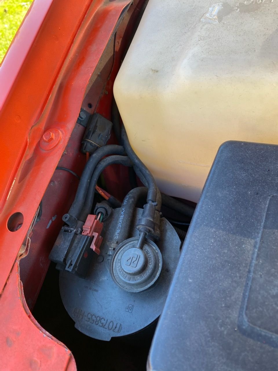

Does your fuel pump do the 2 second prime when the ignition key is turned from off to run ? If no, a quick check of this fuse should be your next step here......
