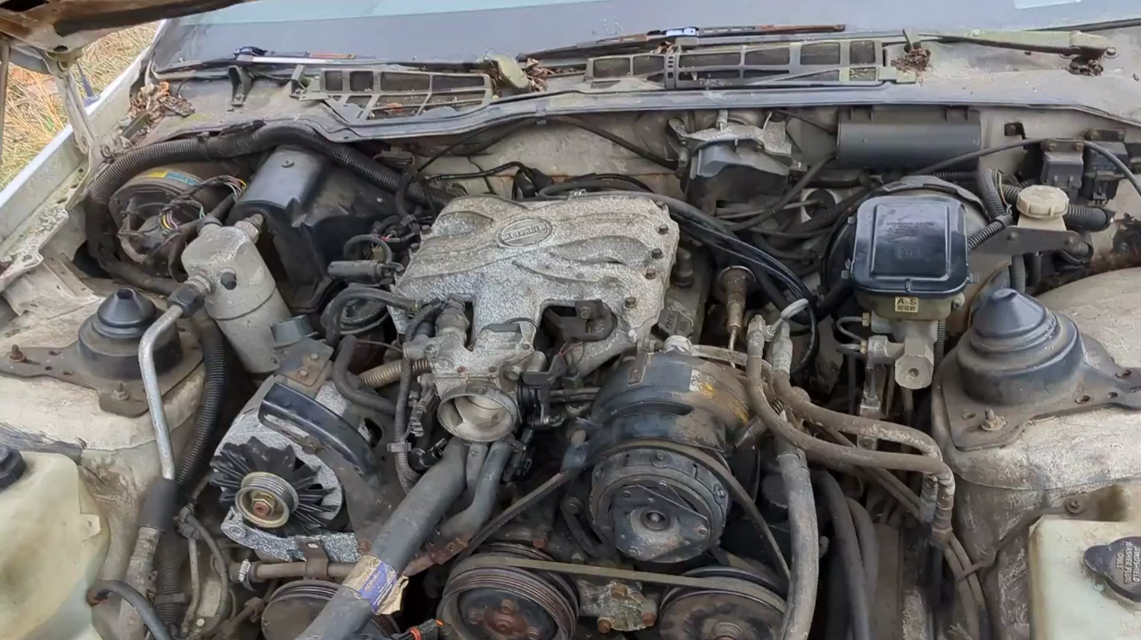

I have a 1986 Camaro with the 2.8L Iron Duke engine with a 5-speed manual. Am doing an engine rebuild on the motor but when I was taking it apart and out of the engine compartment I managed to break what seems like every dry rotted vacuum (I am assuming) line and I can't seem to find an exact replace online for it yet. But my question is if the lines are actually needed and if it would hurt performance at all. If it does does anyone know where I can find a direct replacement?

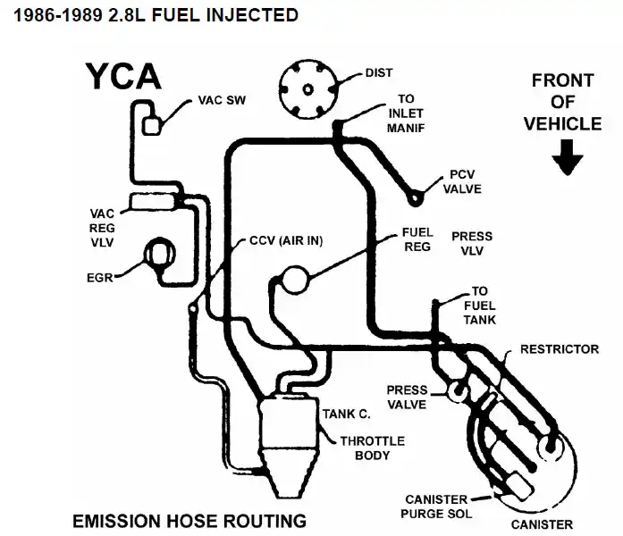

Yep, there'll be a few important vac lines you'll want to sort out, but many can just be plugged (you don't want to leave any vac ports on the engine open). Off the top of my head, the most important ones are:
-the brake booster (large diameter line that runs into the back of the intake)
-Fuel Pressure Regulator (sits behind the throttle body, on top of the fuel rail under the upper intake, towards the front of the motor)
-MAP sensor (can't recall whether or not mid-80s 2.8s had this, but if you do, it'll look like a little black box with a vac port.... on the 3.1 at least, it's connected to the single vac port that sticks out of the back of the upper intake, towards the pass side, left of the "T" fitting)
-Possibly EGR... take a look at that black thing sitting behind your alternator; memory is telling me that this is the EGR on the 2.8s, and that there are vac lines running to it. Check out AustinThirdgen.org, they'll have full factory service manuals with vac diagrams that you can check over. 2.8s had some funny business going on with the EGR/ charcoal can
Aside from this, the other vac lines in your 2.8 should be for accessories/ non-essentials like cruise control (which it looks like you don't have anyways), the heater valve, and HVAC controls (the HVAC is usually plumbed into the side of the "T" fitting on the back of the intake, opposite to the brake booster), and you can just plug them. Don't worry if you snap one of the plastic lines btw, you can just slip tubing over the broken ends, or just replace them completely with rubber line. If you broke one of the plastic lines coming off the back of the throttle body, you can get little plastic "male to male" fittings that will let you hook up a rubber line as well. It may seem like a lot of work, but it's all relatively straightforward in how it's laid out. Just take your time, check diagrams, and plug anything you don't care about I'll come back and edit this message in a sec with a link to the diagrams on AustinThirdgen
EDIT: And here it is! If you scroll down on that page, you'll see the diagram for MPFI 2.8s. I'll go ahead and paste the image below just in case anything happens to the site, I know it's gone down temporarily a few times over the years.... unfortunately only shows the vac lines for emissions (missing MAP sensor/ brake booster and some others), BUT you can also find the entire factory service manual on the left bar of AustinThirdgen; the Firebird ones will be the same (aside from light wiring and such), doesn't need to be the exact year/ model. Looks like they have an '89 Camaro fac manual, '86 Berlinetta manual, and an '88 Firebird manual. Any of those oughta have the 2.8L MPFI diagrams. Good lookin Camaro btw, oughta be pretty fun with the 5 speed!
