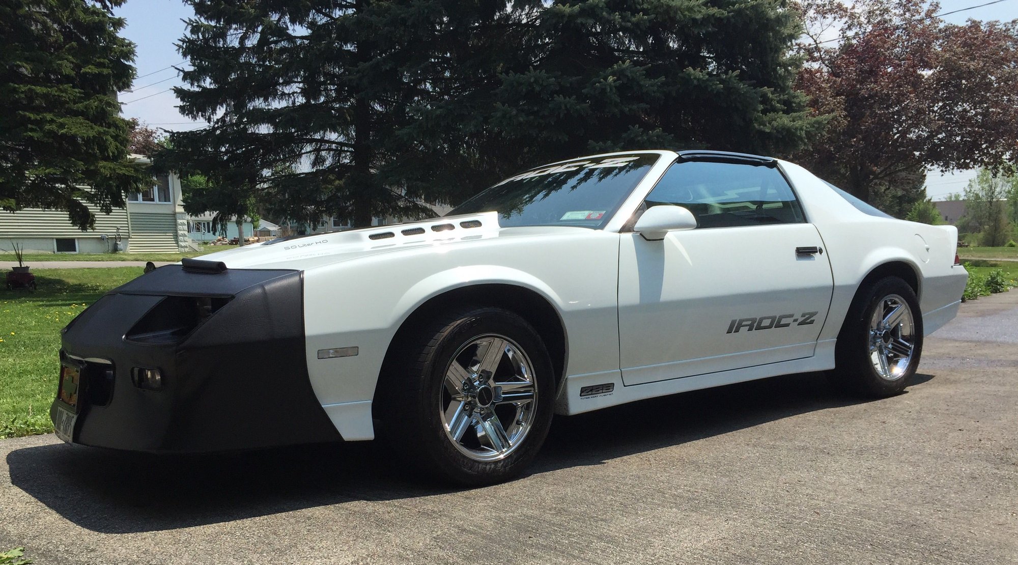

I usually run Toyo Proxy 4s on my iroc, but hear they don't make 245/50/16 anymore. Does anyone know what other size 16 inch Toyo tires I can use that won't rub or throw off the speedometer? Thanks in advance!
