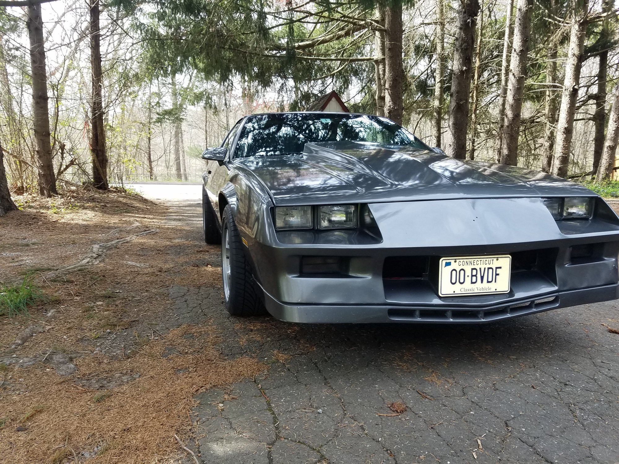

C5 Z06 Setup
Rear:
Stock C5 Z06 Wheels (18x10.5)
Toyo Proxes TQ drag radials
315/35R18
LS1 width Strange S60 (2" wider per side)
Grinding needed on control arms.
Bashing needed on inside front of body.
Rolled fenders, but tires probably won't ever go up that high.
Front:
Stock C5 Z06 Wheels (17x9.5)
Riken Raptor ZR
275/40R17
1LE spindle/hub setup from BBU.com (about 1" wider per side)
3.5" wheel studs
1.25" spacers used (ideally need 1.375 and longer studs/use spacer with secondary studs)
Only 5.5 threads of engagement
Slightly ground strut bracket and tie rod end edge to clear wheel weights
Lowered 1/2 - 1 inch with weight jacks.

Looks good with your exterior color. Before you go hacking your stock pieces just look into a set of tubular lower control arms. Founders sells them for the lowest amount. Until you do a mini tub tubular LCA should work fine... If not you would need to look into custom stuff.
There is some good information in this thread: https://www.thirdgen.org/forums/fabr...-out-poor.html

I agree with the color combination. The stock LCAs are boxed, and it was really just the flanged portion that needed clearance, so no big deal. If they weren't already boxed I would definitely just buy founders set.

I have no clearance issues at all. Running founder control arm's and eibach pro springs

Looks good. Expect pictures Saturday of mine a little lower with the panhard bar lowering brackets installed.

Unfortunately I got the wrong U-bolt with my panhard bar lowering kit, so I am not finished yet. Hopefully Wednesday I'll get it finished up.
