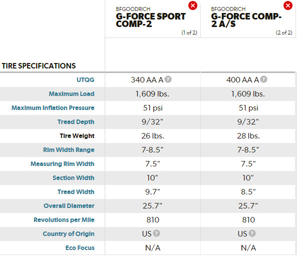

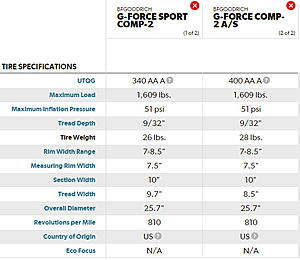

I appreciate the feedback, all. I was leaning toward summers to begin with... I think either tire would be good.
Looking at the specs, the AS has a better UTQG but is 2lbs heavier and a bit narrower on the tread width which I think seals the deal in favour of the summer version.

I had Sport Comp 2's on my daily as well as my T/A. I never had an issue with them in the cold as long as the road was dry. They do start to get very loud and hard below about 10°C. They're great in the rain too for a summer tire.
