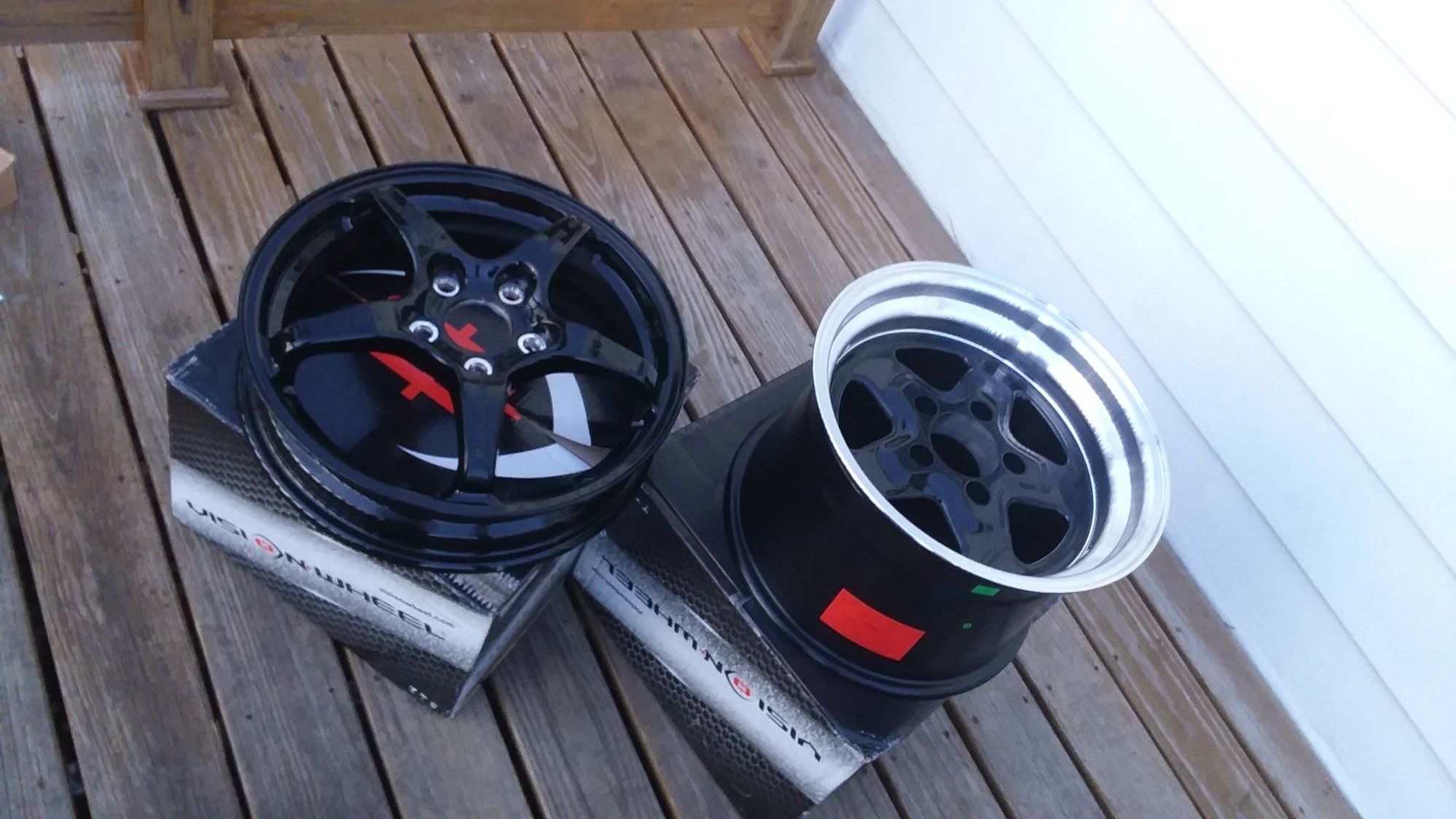

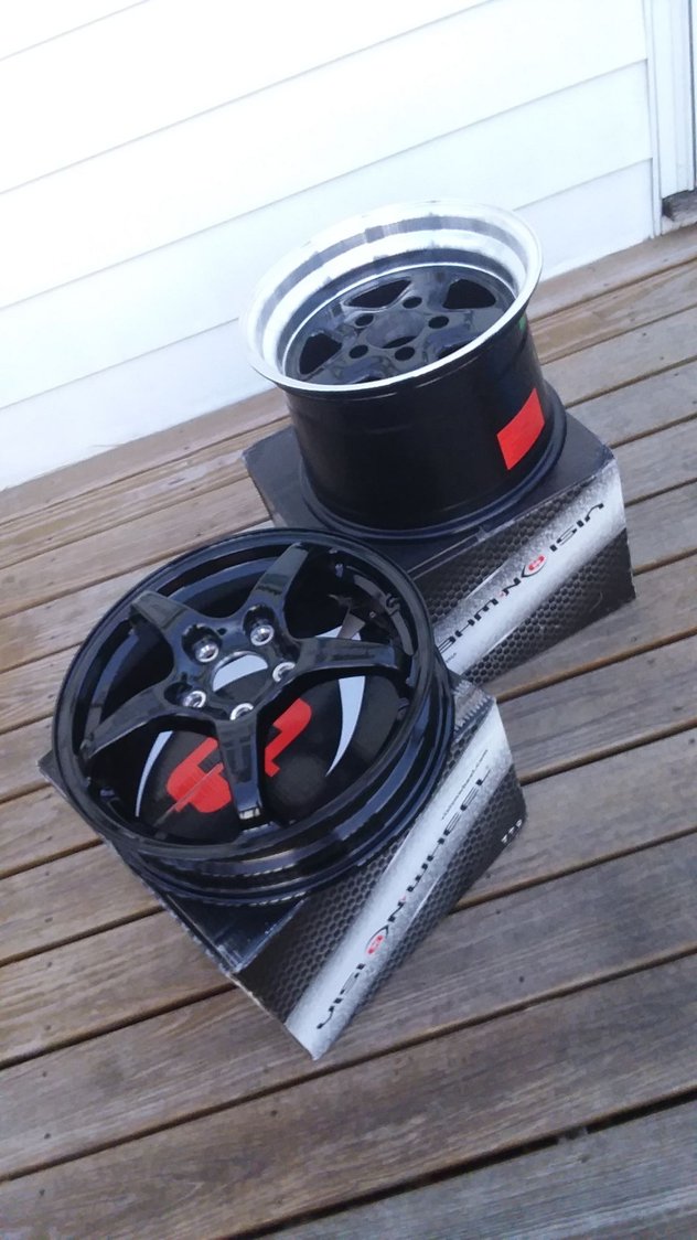

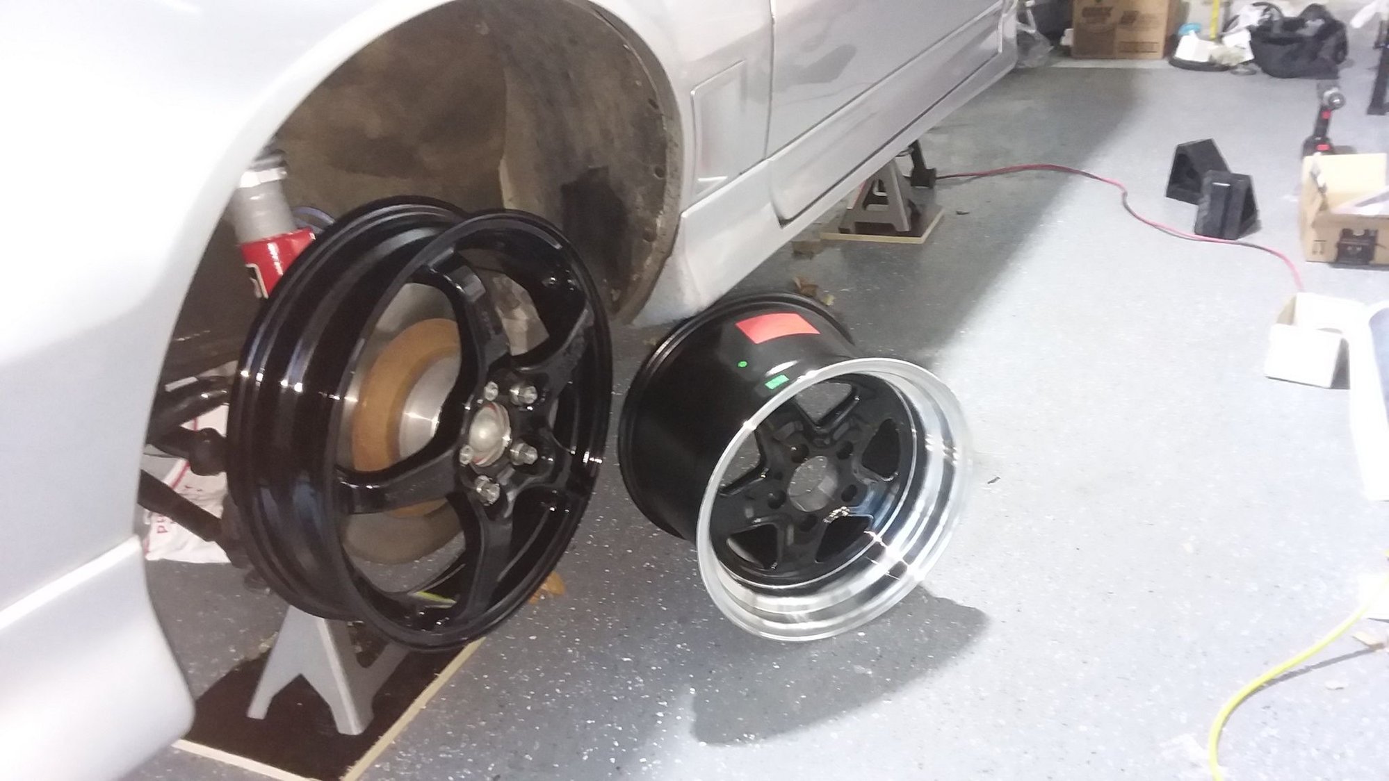

15X10 with 6.5" BS. They will fit fine with the bumstops off and some BFH taps lol. Weight is 20lbs vs the front GTO spare is 14lbs. Great setup for cheap.
