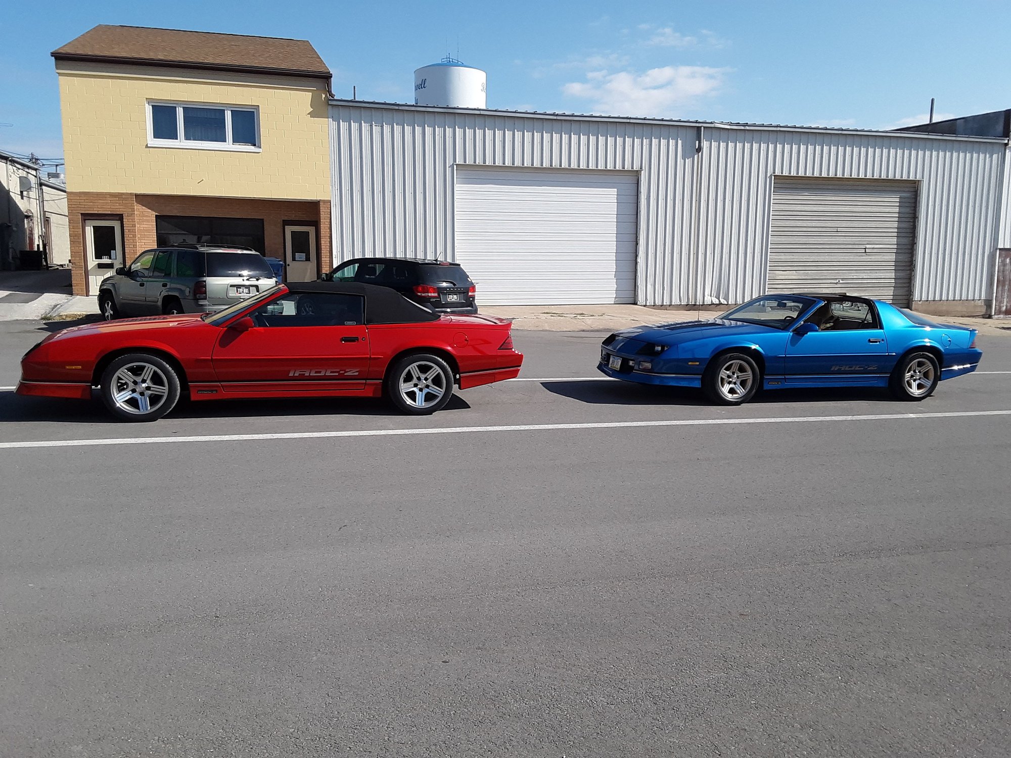

Quote: Hey Joe, I didn't have any worries with the stud length when I installed my wheels with the spacers with stock brakes. You will absolutely LOVE the wheels!!
Here's a couple pics of my cars together for a comparison. One with the 17's and one with the factory 16" wheels
Wow it makes the 16” wheels look like the 15”s when you see them next to each other...
People keep saying how great they are in person too...
That Red very looks amazing BTW... what a transformation!

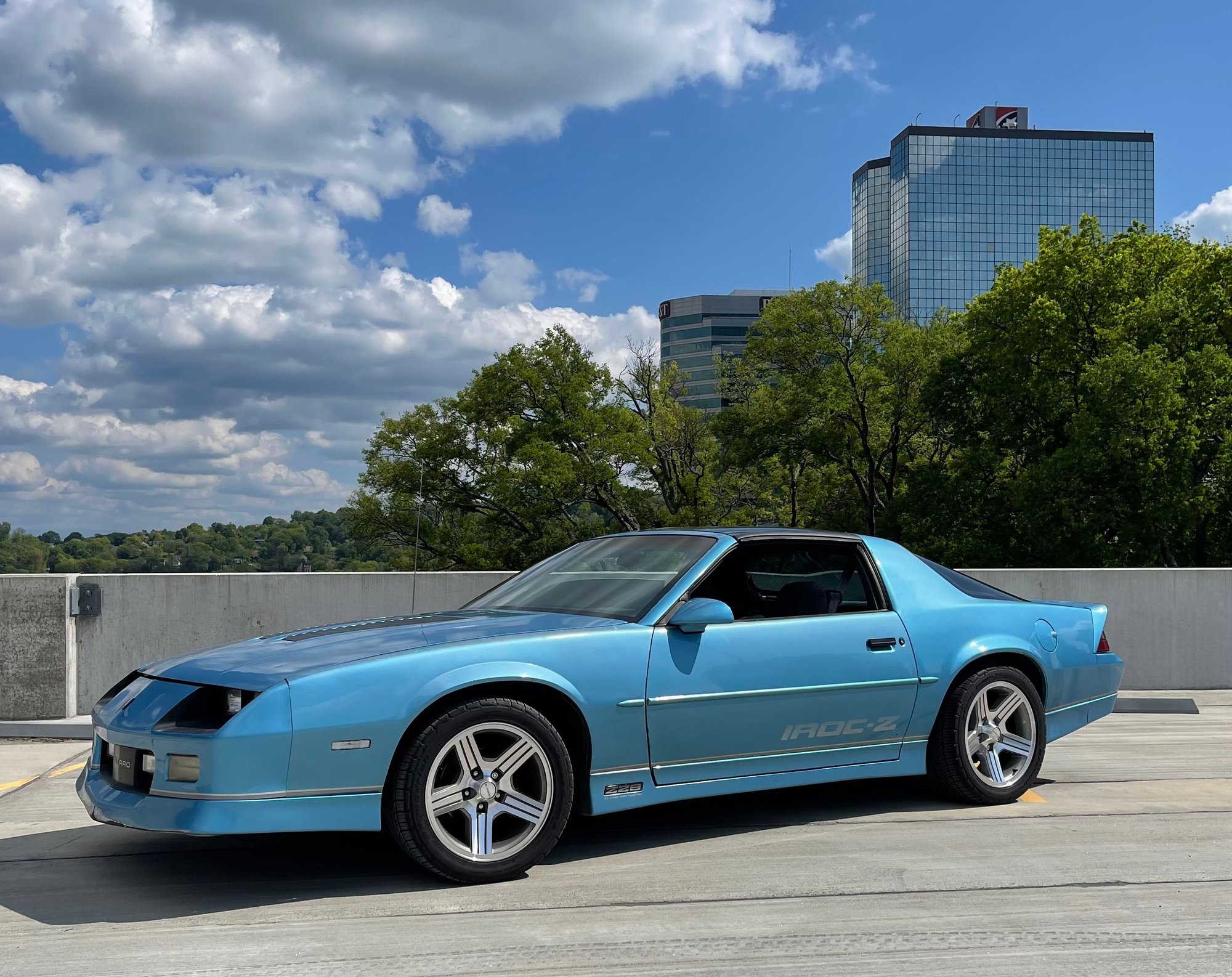

They look even better mounted on the car. Took this picture a couple of weeks ago.

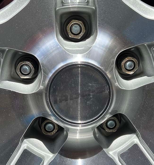

I picked up some 54mm studs for the front wheels. The grip length is perfect with the spacers in place. I will probably replace the rear studs too as stock length is marginal but probably safe? For how many of you are using these wheels on your cars I'm very surprised this problem is not mentioned here and even more surprised Hawks does not recommend changing the studs when using these wheels especially with spacers in the front? I also recommend cutting the tab off the struts as it is very close to the rim.
Here is the grip length on the front. I'm sure I would pull threads if I tried to torque to 100ftlbs!
Here is the rear grip length. Probably safe but still marginal.
With 54mm studs its perfect.

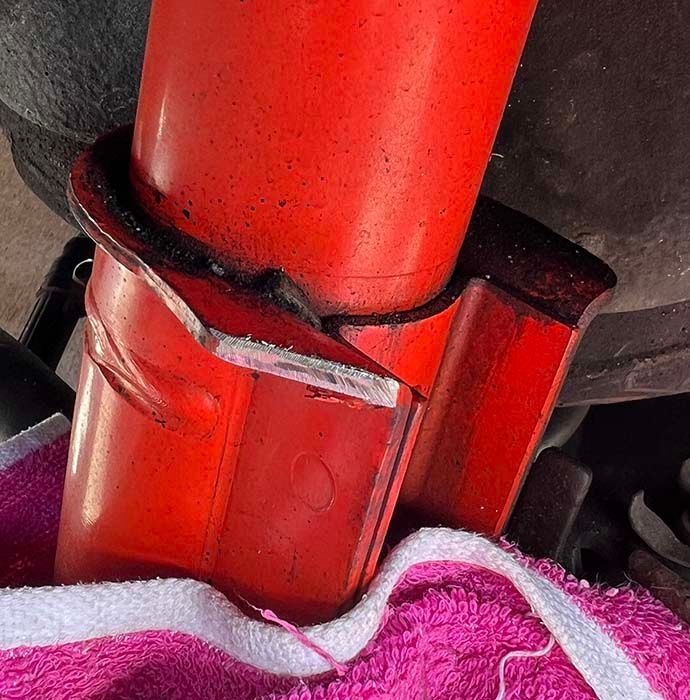

This tab on my Koni struts is very close to the 17" rims. It was actually nipping at one wheel weight. I think stock struts are the same?
Problem solved.

I've never felt safe going high speeds in my car after seeing how little meat the lugnuts had to grab onto. Does anyone have a link to a set that would work? I'd like to use ARP but it sounds like the holes in the hub will need to be drilled out or risk cracking particularly if they have been machined down for BBU.
Reply 0
Apr 22, 2023 | 12:45 AM
  #431
Re: 17x9 IROC wheels coming from Hawks!!!
Quote: I've never felt safe going high speeds in my car after seeing how little meat the lugnuts had to grab onto. Does anyone have a link to a set that would work? I'd like to use ARP but it sounds like the holes in the hub will need to be drilled out or risk cracking particularly if they have been machined down for BBU.
You should be very concerned even at low speeds.
This is what I used: Make sure you press/pull them in completely.

I agree with those that said there's not enough thread engagement on the stock studs. I could get maybe 6 turns torqued down on the stock wheel studs. Hawks should really mention this with these wheels and imo, should include new studs with them. They do look great but I'm not going to run them on stock studs.
